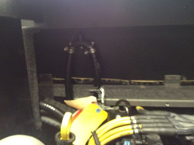

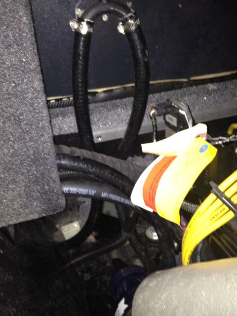

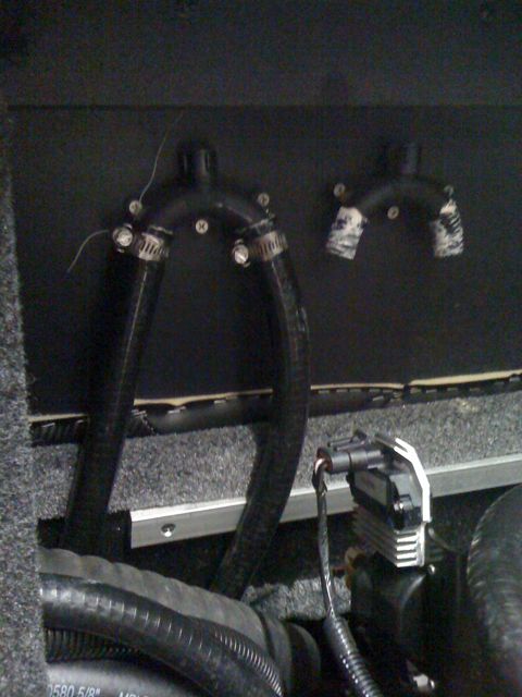

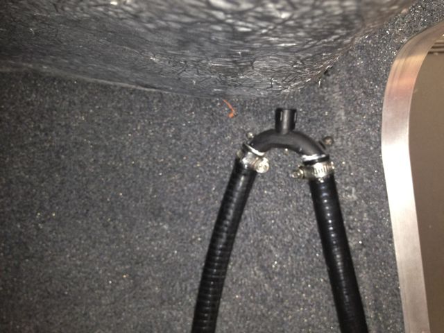

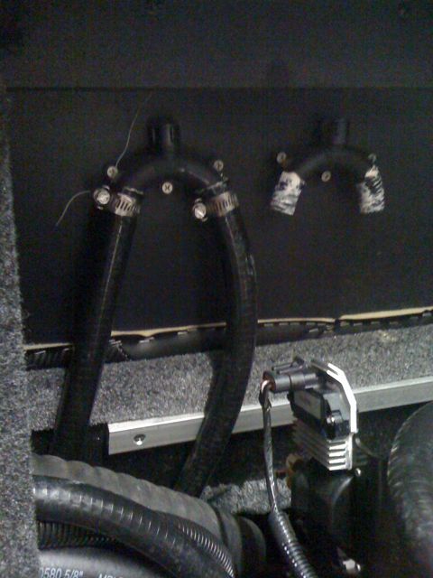

Start by removing the the cover under the skybox seat and the engine cover, remove all hoses from the vented loops and take off the 2 inner vented loops, (these just keep the water from syphoning out of the bags, you only need 1 per side) follow the hose from the pump and hook it to the inner leg of the loop, then run another hose from the outer leg to the top of the bag, then take the one going into the floor hooked to the tank and hook it to the front lower port on the bag. Do this on both sides and you're done in the rear section.
File comment: look on the seat back just in front of the engine, locate the 4 plastic hoops, 2 on each side with hose attached to each, remove all of the hoses from the hoops
File comment: on each side remove the hoop closest to the engine, you do not need 2 on each side, 1 for the left and 1 for the right is sufficient
File comment: follow the hoses from the pumps, (next to the transmission) up to the hoops and connect the pump hose to the inside hoop leg, the one closest to the engine, do this on each side

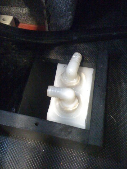

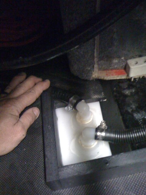

File comment: its not necessary but if you want the bags to drain and not take forever remove the cover for the tank fill and vent and turn the forward fitting so it faces forward, I went counterclockwise just to make sure
I didn't over tighten it.

File comment: put the thin hard plastic line on the rear outlet and let it point toward the engine(this is the factory vent line), take the extra piece of hose you removed from the hoops and attach it to the fitting facing forward
File comment: this hose will connect to the front lower port of the bag

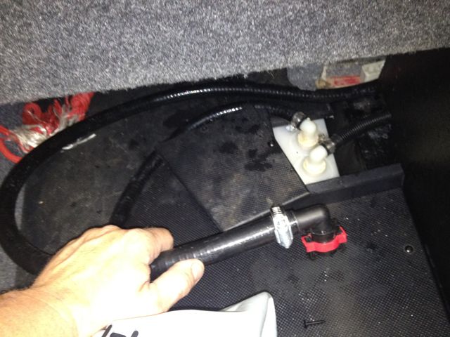

When you are finished with the rear section you should follow your hoses to make sure they are right, start at the pump in the floor, then it should go to a hoop on the seat back, from the hoop to the top of the bag, from the front lower port on the bag to the tank, done, I have tried many ways on hooking up the bags and this is the most foolproof and hassle free way to do it without spending a ridiculous amount of money trying to save yourself 5 minutes.

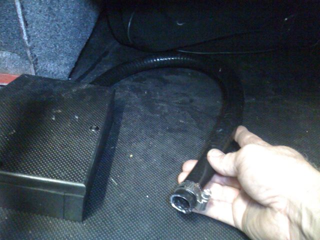

File comment: try to keep this hose between 18-24 inches and I recommend not using a quick connect fitting, it drains faster without all the 90 deg fittings, if you have to use one get a straight fitting

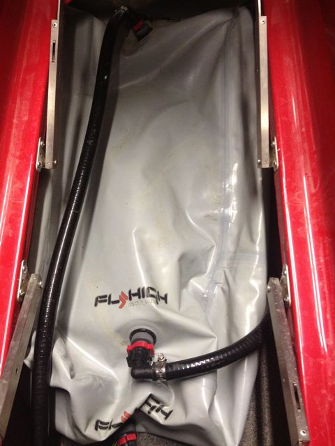

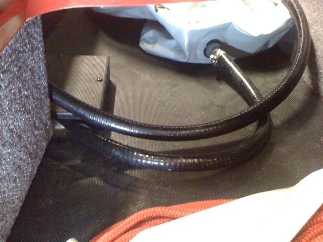

File comment: loop it around to the front of the bag and hook it up

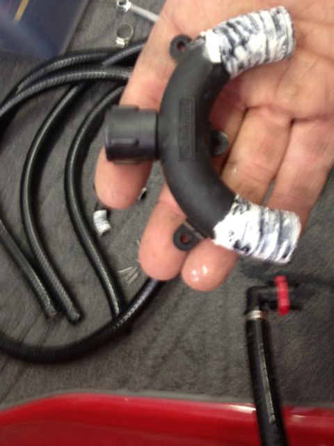

Look under the chillax seat and find the Y connector, disconnect the 3 hoses going to it, the one going to the front headed under the helm is the vent, put a 90 deg fitting on this hose and hook it to the top rear of the bag, this is where the most air pockets get trapped and the only way for them to get out, flip the switch that says front to drain and find the hose making noise, hook this hose to the lower rear port of the bag with a straight fitting. the last hose should be the fill hose, I have spent a lot of time messing with the front bag and check valves and all sorts of things and this is the best way so far to fill it and not have problems. First off you will need an extra 6-8' of hose to do this but its cheaper than the check valve anyway. recycle one of the hoops you took off the rear and mount it with 1/2 long screws as high as you can up by the glove box, run the hose from the fill pump to this, run the new hose you purchased from the hoop to the farthest forward port on the bag. I tested last weekend and the bag no longer mysteriously drains or auto-fills due to pressure being behind the check valve, it will now work just like the rear and front tank. no more having to shut off the valve on the pump, just fill and go. be sure to feel the thickness of the fiberglass before you go screwing around, every boat may not be exactly alike, mine had about 1-1/2 inches of thickness right by the radius so there was plenty of material to screw to, just be careful and make sure you don't poke through the other side.

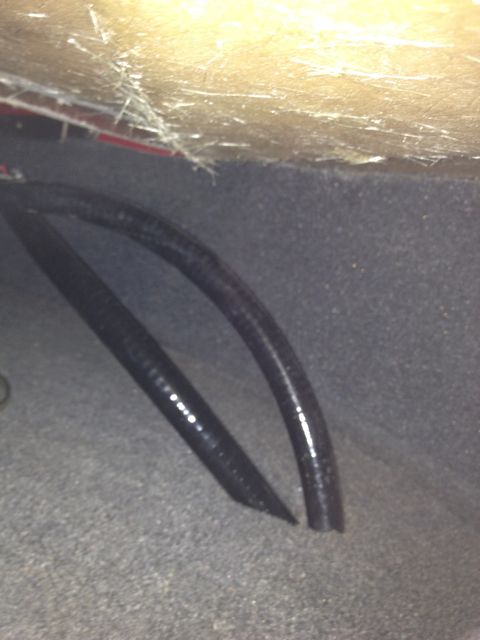

File comment: recycle one of the hoops from the rear

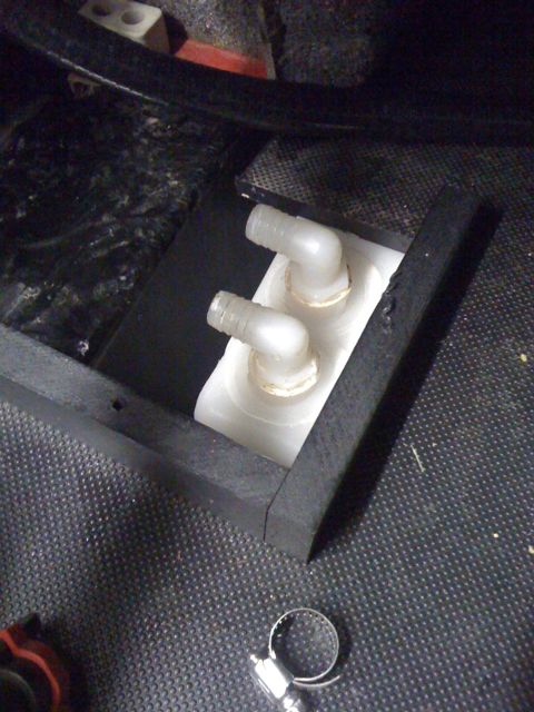

File comment: this is the front bag fill pump and just above it is the tank vent line

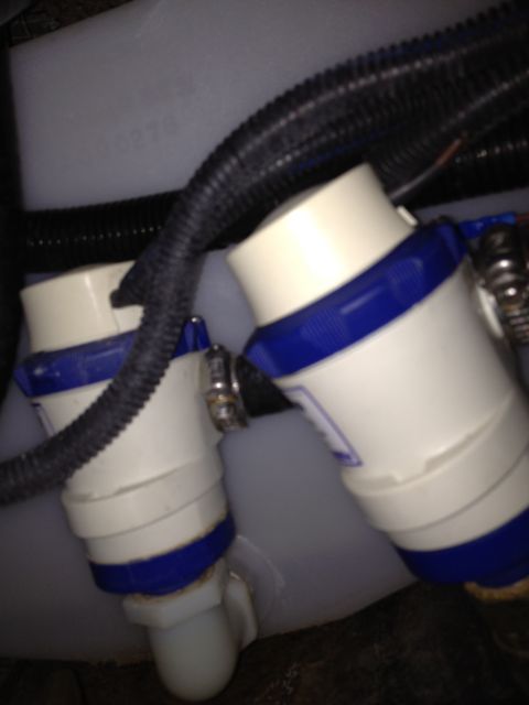

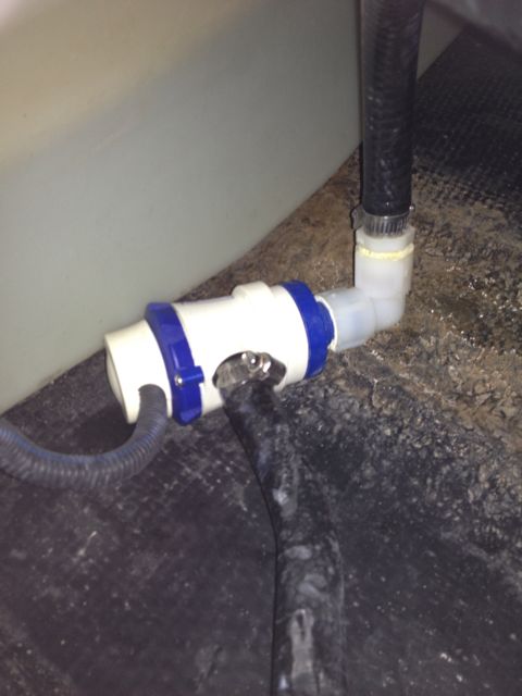

File comment: these are the tank drain and fill pumps
