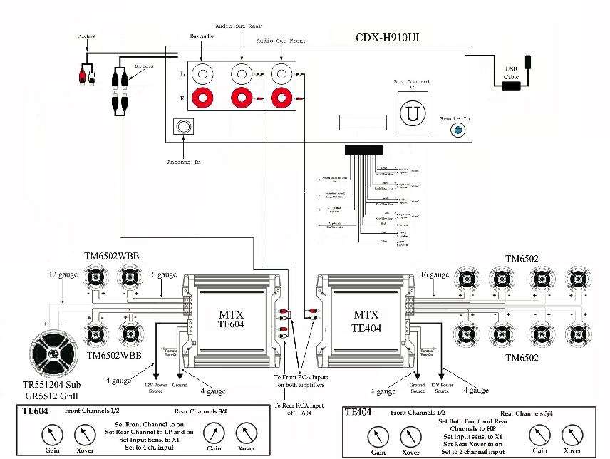

Hope this helps with the factory wiring.
