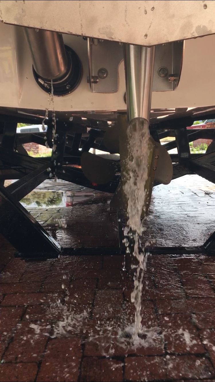

I just installed FAE on my 2015 A20 about 3 weeks ago. I would imagine it would be a similar project. If you are in any way handy, you can do it. It’s not hard at all. Follow the directions and take the measurements it tells you to.
A couple things I would recommend-
1- remove the swim platform. It’s really easy to do you’ll need someone to help you. It’s heavy for one person
2- don’t forget any of the washers! When you tighten the bolt or nut will easily dig into the metal of the bracket
3- don’t tighten the nylon washers down until you are 100%
4- be careful installing the adapter piece that replaces the flapper. Don’t strip the screws w a drill.
Good luck! I’d guess you can do it w 3-4 beers and 2-3 hrs.

Did you remove the factory muffler when install the FAE?
 Post subject: Re: Axis Fresh Air Exhaust
PostPosted: Thu Jun 06, 2019 8:27 pm
Joined: Mon May 25, 2015 10:57 am
Posts: 44
I didn’t. I asked the FAE guy and he said there have been lots done w out doing that and no reported issues.
Any sense if you mileage was affected?
PostPosted: Thu Jun 06, 2019 10:18 pm
Posts: 44
I have noticed a slight decrease in mileage. Doesn’t affect our lake days. I can still make it on a tank for a full day of boarding and 6-10 adults in the boat. The noise reduction is fantastic.
If you remove the factory muffler you will probably see a little performance increase.
On the factory surf pipe option it is removed because of excessive back pressure.
