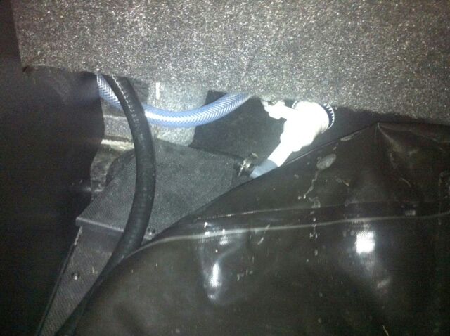

I T`d into the drain from the sack to the hard tank with the pump.

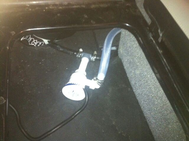

I ran the pump output into the drain line from the pump in the hard tank.

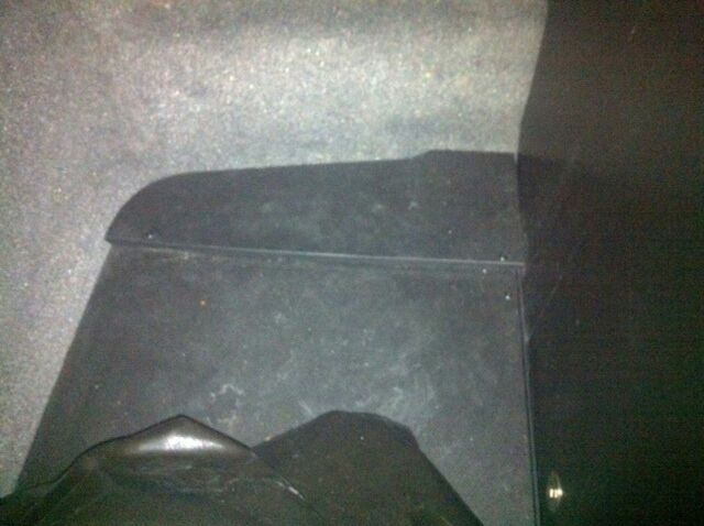

Remove the cover in the back of the v-drive compartment. You will see the other pump in their. Splice the wires from your tsunami into the wires in here. Brown to brown, black to black.
