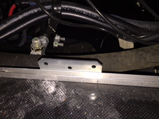

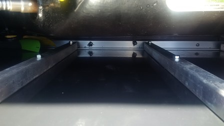

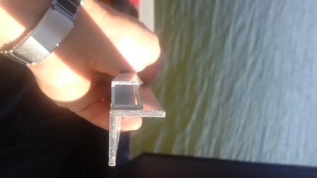

I just finished upgrading my 2015 A22 floor U channel as the 1100 bags where too much for them.(I was surprised when I removed them and there was only three 1/2 inch screws holding them in the hard tank cover). I went to home depot and bought the aluminium 1/2 inch U channel and 1 inch angle iron, in Canada the two 8 ft sections came in at about 35bucks. I also picked up some 1 inch #12 Stainless steel screws at bolt supply (home depot wanted 1.28each bolt supply was way cheaper). I removed the screws holding the hard tank cover and then screwed thru the 1 inch angle iron (pre-drilled holes) and hard tank cover into the fiberglass channel. To attach the u channel to the angle iron I used Gorilla glue. Be sure to make the new u channel approx. 44inchs long to support all the divider panels.
To beef up the removable divider I used 1inch square aluminium tubing (3 for each divider) and mounted using a flat head carriage bold.
Was out yesterday and it is working great but I did notice the back permanent divider piece was flexing about 1/2 an inch so I will put a 1 inch piece of tubing on that panel as well.
