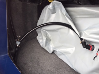

File comment: Here's the rear 750 PNP fly high bag. Seems to fit custom in my A22

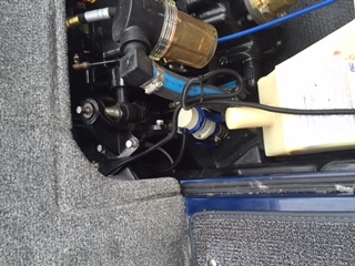

File comment: The fill pump with a shutoff is located directly behind the fuel tank underneath the removable step

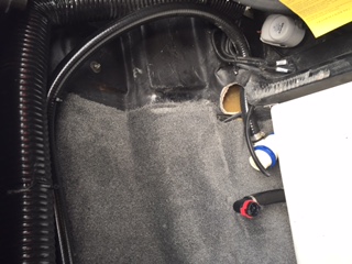

File comment: The hose goes up to this anti syphin loop located on the back side of the rear seat cushion in the engine compartment.

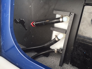

Here's more of the ballast set up

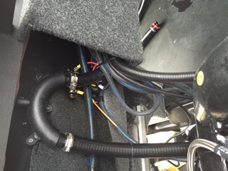

File comment: After the loop it comes around and down to fill the stock hard tank. It's fills through the middle connection. The far right is what attaches to the front of the PNP bag to fill and drain the bag. The far left is a small vent line for the hard tank that goes straight out a through hull fitting.

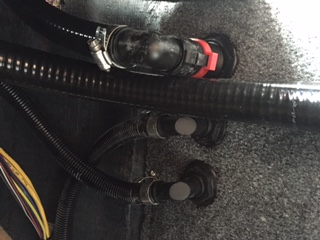

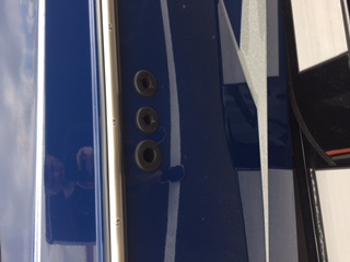

Here's the thru hull fittings. Looking from outside the boat the rear most port is the drain. The middle is a vent for the stock hard tank. And the furthest forward to the right is the bilge
File comment: Here's the thru hull fittings on the starboard side. This is taken while lying on my back looking up at it. The far right is the drain. Middle is the vent for the stock hard tank. And far left is the bilge.

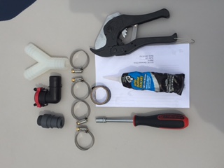

File comment: Here's everything you need for the install of one side. Not pictured is about 8' of 1 1/8" ballast hose from wake makers.

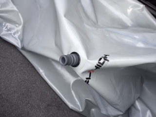

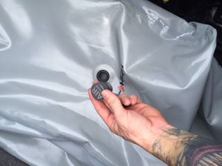

File comment: Remove the air vent on top of the bag
File comment: Screw in the straight fitting to the bag where the air vent was located.

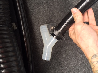

Measure out how much hose you will need and cut it with a pvc pipe cutter. Then attach a Wye. This one was bought from board stop. Use silicone and hose clamps. It's also a good idea to wrap all clamps with electrical tape so that they don't puncture the bag.

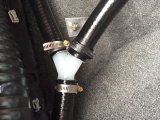

Cut into the drain and attach he Wye in the same way that you did before.

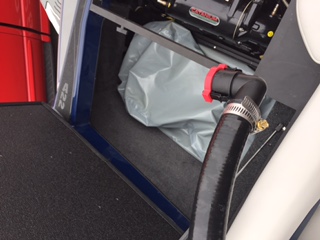

And that's it. Attach the Elbow to the straight fitting on top of the bag and you are done.
