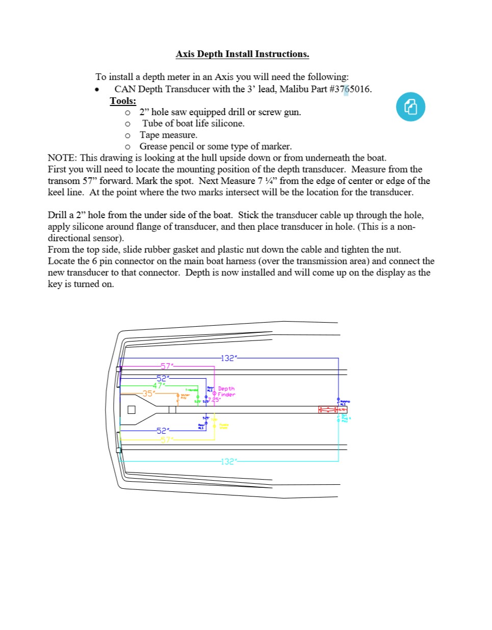

Got install instructions from Axis in case anyone finds them useful
