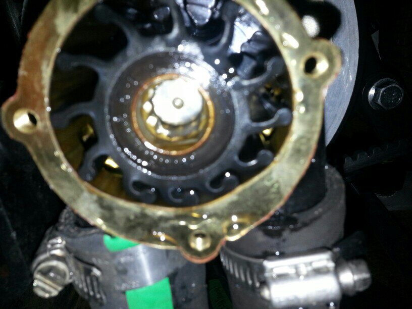

vanamp wrote:
http://www.amazon.com/Sea-Dog-660040-1-Impeller-Puller/dp/B002FVKBSI
I got this one. With free shipping it was only a few dollars more than bakes.
My impeller was stuck pretty good. With the puller I was able to remove it without damaging it to keep as a spare.
Did you bump the engine once you removed the faceplate? I did and once I found the right angle to get to the impeller and apply leverage, it slid out.
 Post subject: Re: 2012 axis a22 no plug and play?
PostPosted: Fri Apr 24, 2015 6:25 am
Posts: 272
The boat is stuffed in my garage with tower folded and batteries out on charger. It was just easier to get a puller. It was snowing out earlier in the week so there was no real hurry.
[attachment=-1]uploadfromtaptalk1429897151461.jpg[/attachment]
I am not saying "don't buy one". If you pull yours like you said, then you probably need a puller. I had my boat in the water a couple of weeks ago and then I bumped the key after the faceplate was off. It slid right out. The new one was easy to put in as well.
