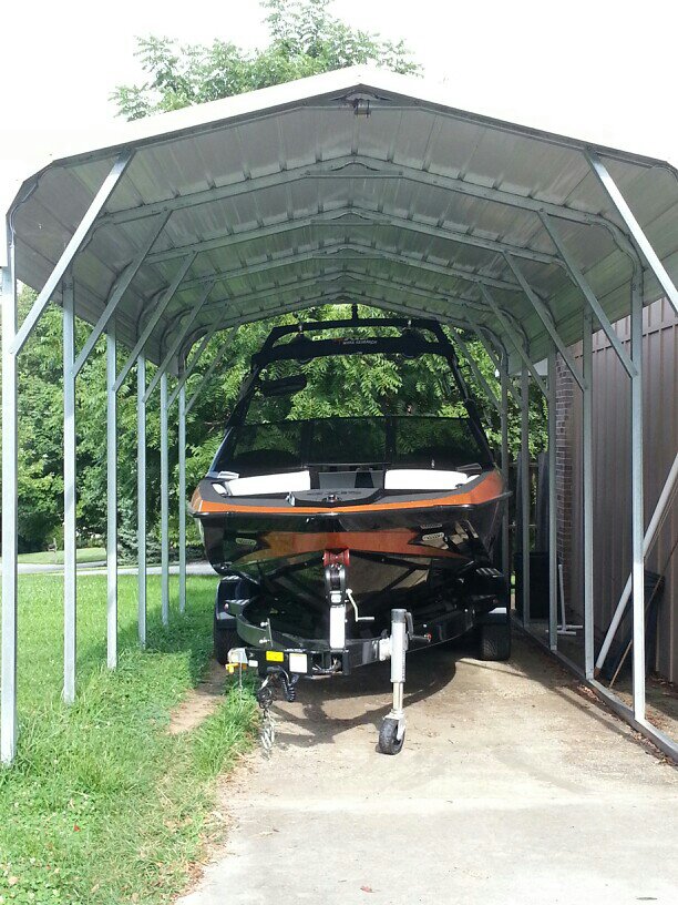

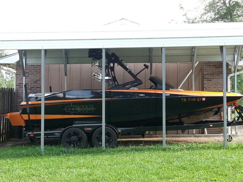

[attachment=-1]uploadfromtaptalk1406842805571.jpg[/attachment][attachment=-1]uploadfromtaptalk1406842818738.jpg[/attachment]
Mine stays uncovered rarely. I took it out last night and plan to take it out tomorrow so I left it this way today. Mine also sits on the north side of my house. For the most part it doesn't get much sun. I suggest side pieces if you have it in the open.

It will make it a tight fit but I suggest doing 8 foot legs. I wished I did so it stays more covered.
