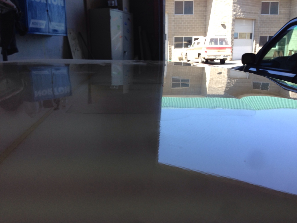

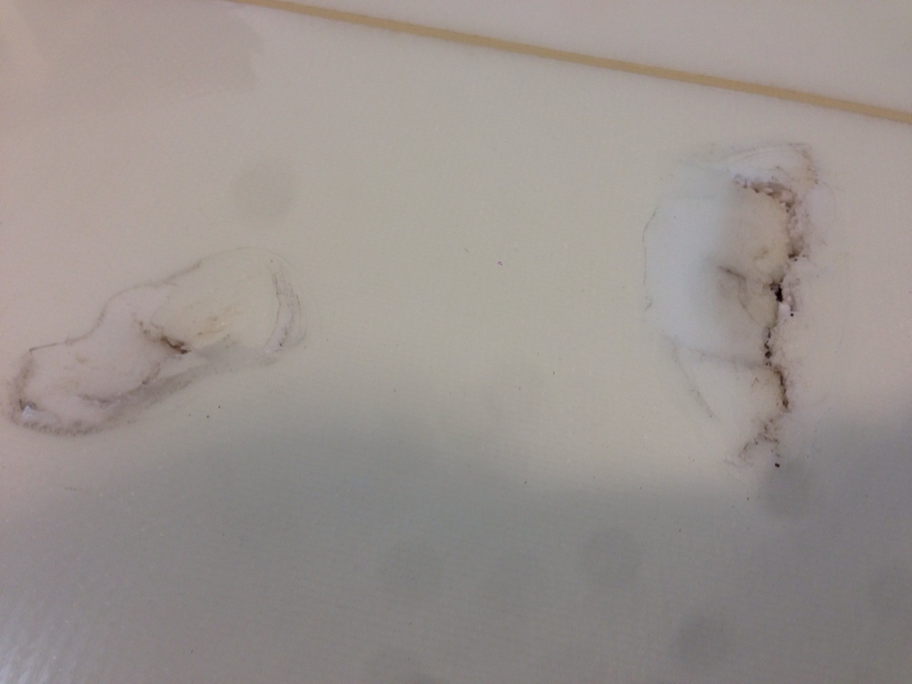

solarez is what I use

nice....heck, great work scmart1 My repair with solarez definitely worked, but isn't as beautiful as your work for sure
