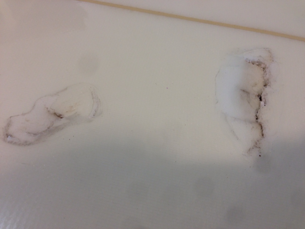

What did you end up doing for this? I have a couple chunks taken out on the tip and also a little crack and dent on the top part of the board.
This sucks, because the board is literally two weeks old.

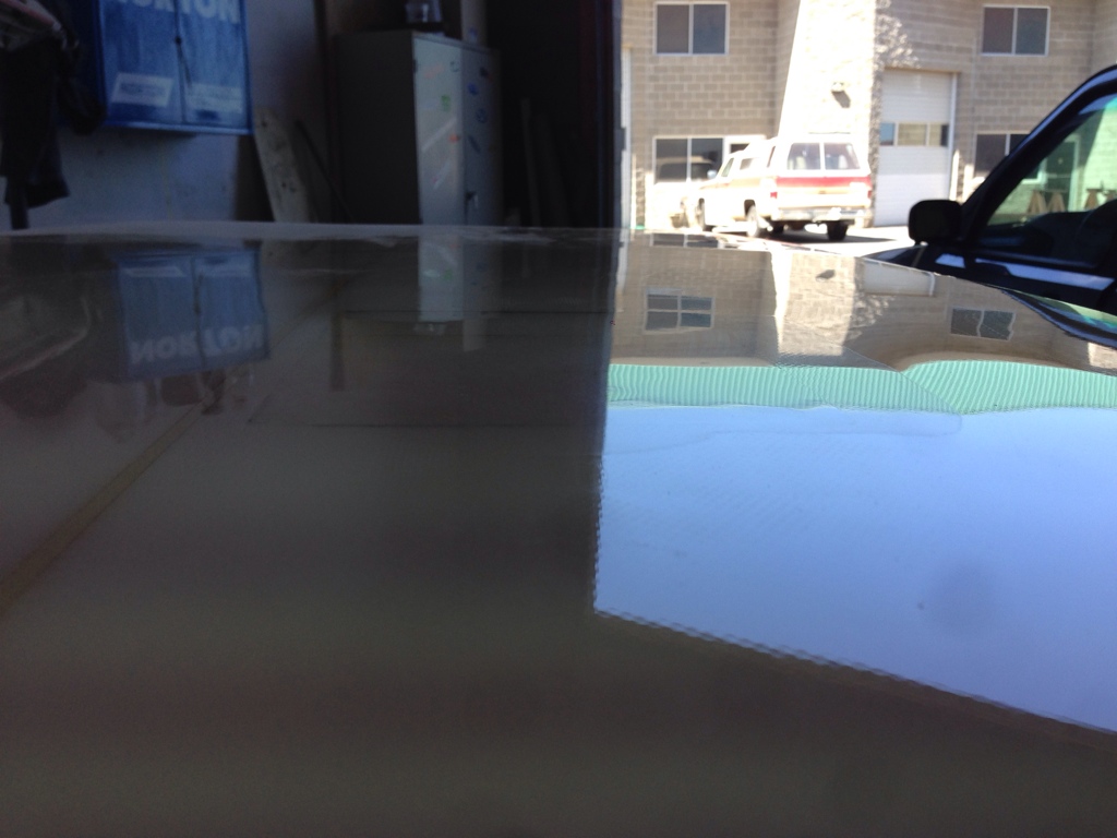

solarez is what I use

nice....heck, great work scmart1 My repair with solarez definitely worked, but isn't as beautiful as your work for sure
