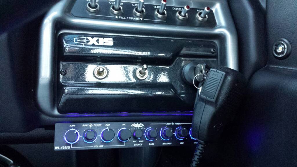

Here is what it looks like 2013 model a22

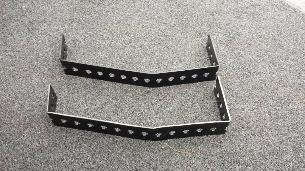

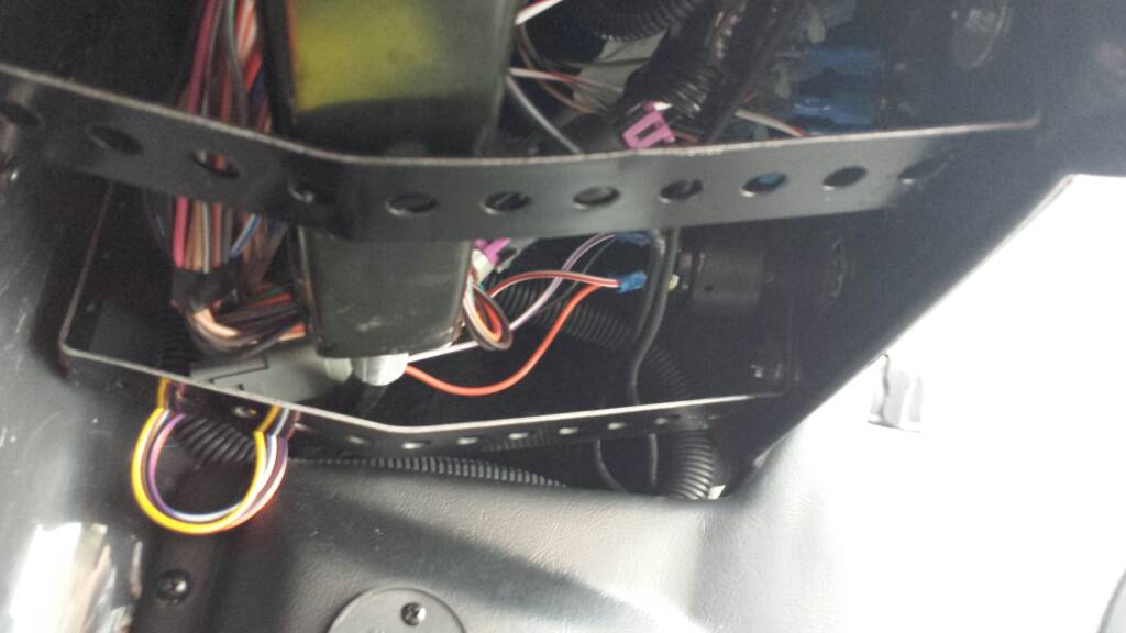

I made my brackets from some hangers that you can buy at lowes. You need some tin snips to cut them, fender washers and replace the two lower machine screws in the dash with longer ones.
