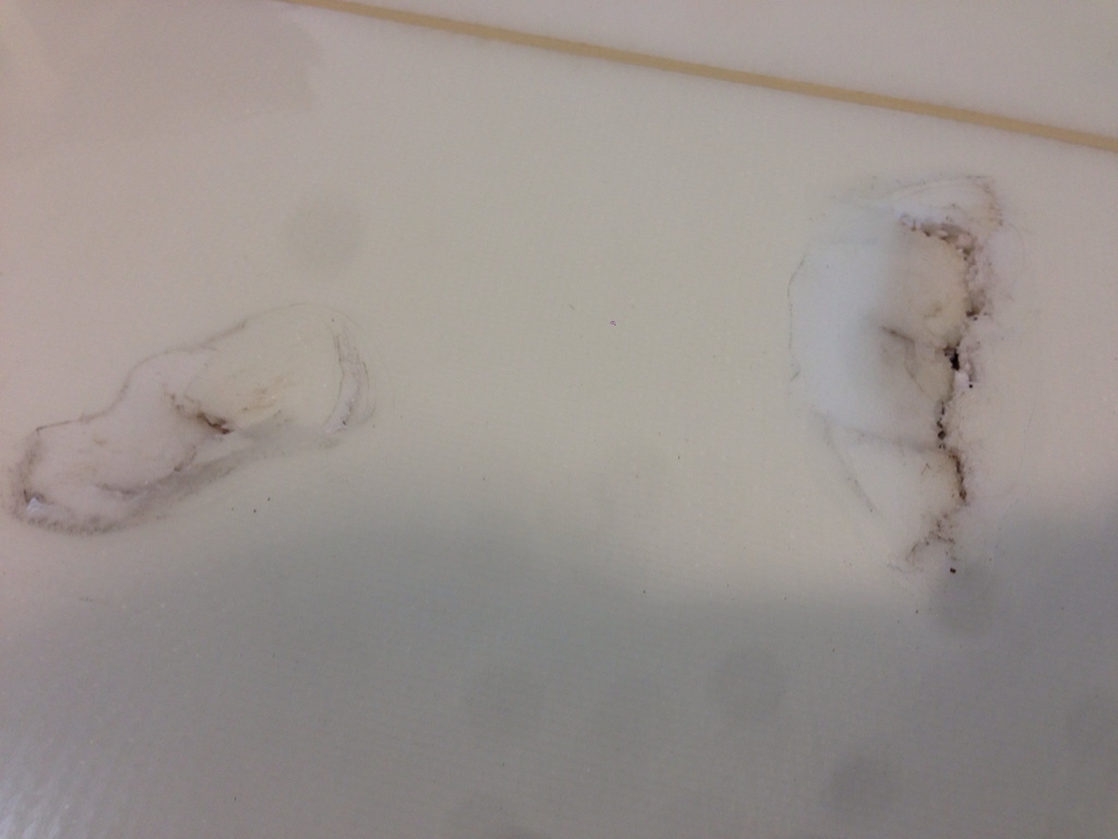

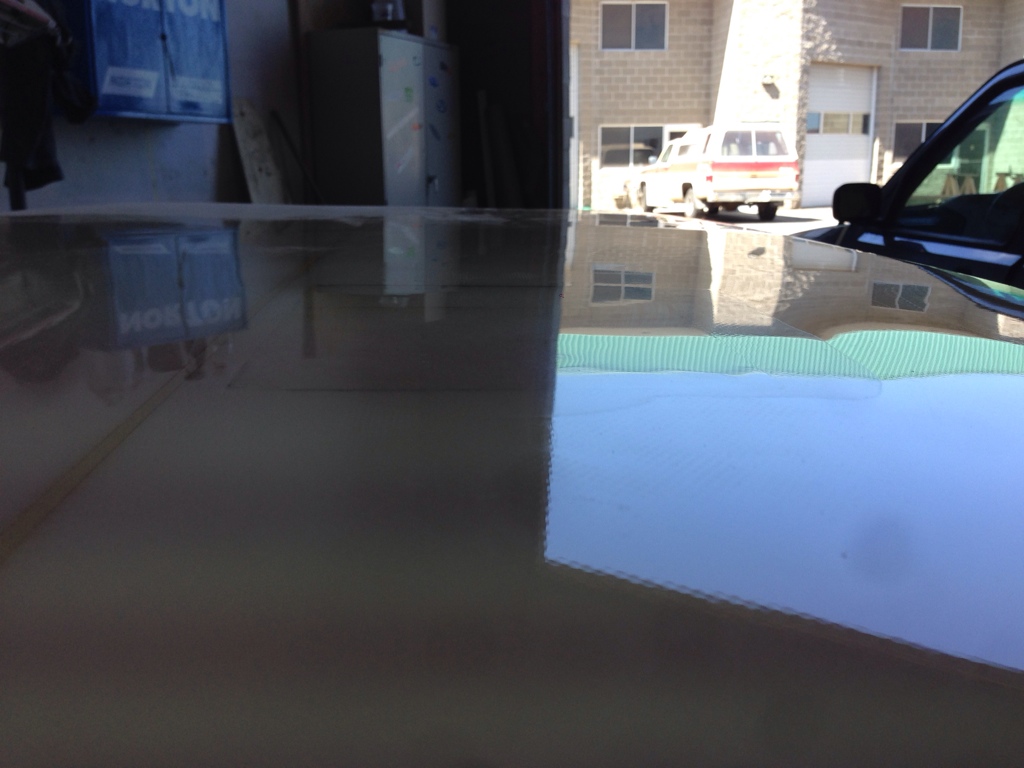

 Post subject: Re: Board Repair Tips?
PostPosted: Tue Jul 22, 2014 5:50 pm
Posts: 100
Location: Kelowna B.C
solarez is what I use
PostPosted: Sun Aug 10, 2014 12:04 pm
Joined: Sun May 18, 2014 7:34 am
Posts: 14
Location: Belton, TX
nice....heck, great work scmart1 My repair with solarez definitely worked, but isn't as beautiful as your work for sure
