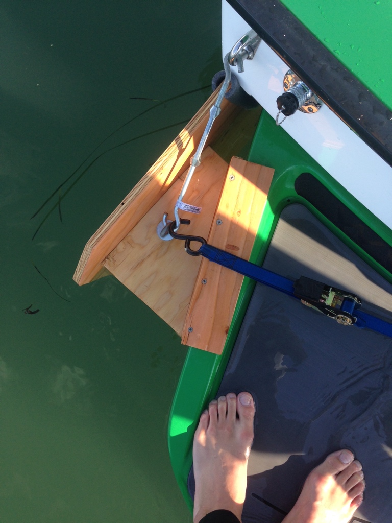

We call ours the ghetto gate but for it we use a turnbuckle and have a tie down going across the stern of the boat, it is on there solid.

John. You have proven you craftsmanship and demensions, now go buy a sheet of HDPE. One strap loop from the bar under the swim deck to the tie down loop should be able to hold it in place securely. Enjoy!

I've become a bit mesmerized with the wickedwakesurf.com A22 kit, but idea of drilling holes in the swim deck makes me a bit squeamish. Now the HDPE with the eyelet and strap definitely have my attention!
