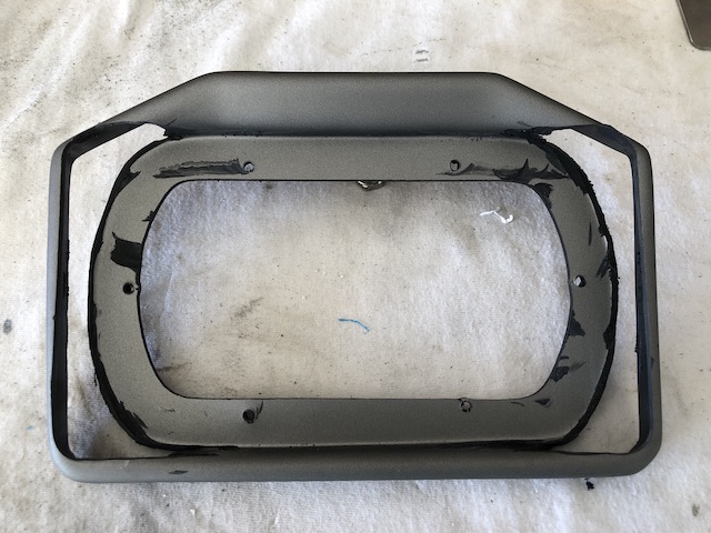

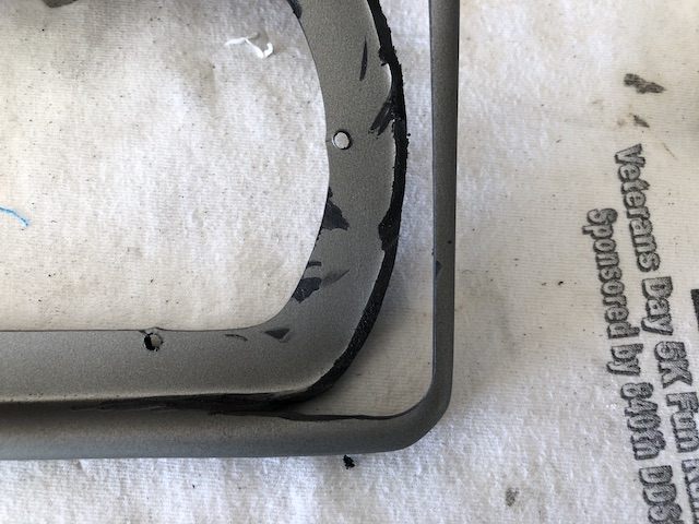

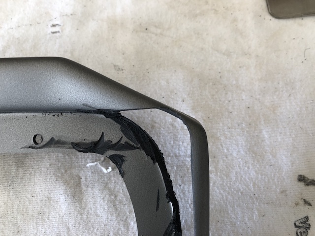

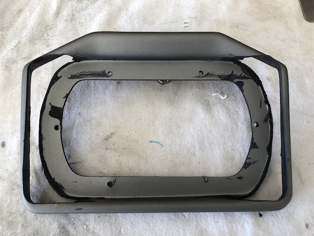

For the control head, I was able to carefully slowly cut the silver dash trim ring enough to maintain integrity in the plastic AND allow the controller to be mounted in it. I also had to use a scrap piece of aluminum to make the mounting bracket work.

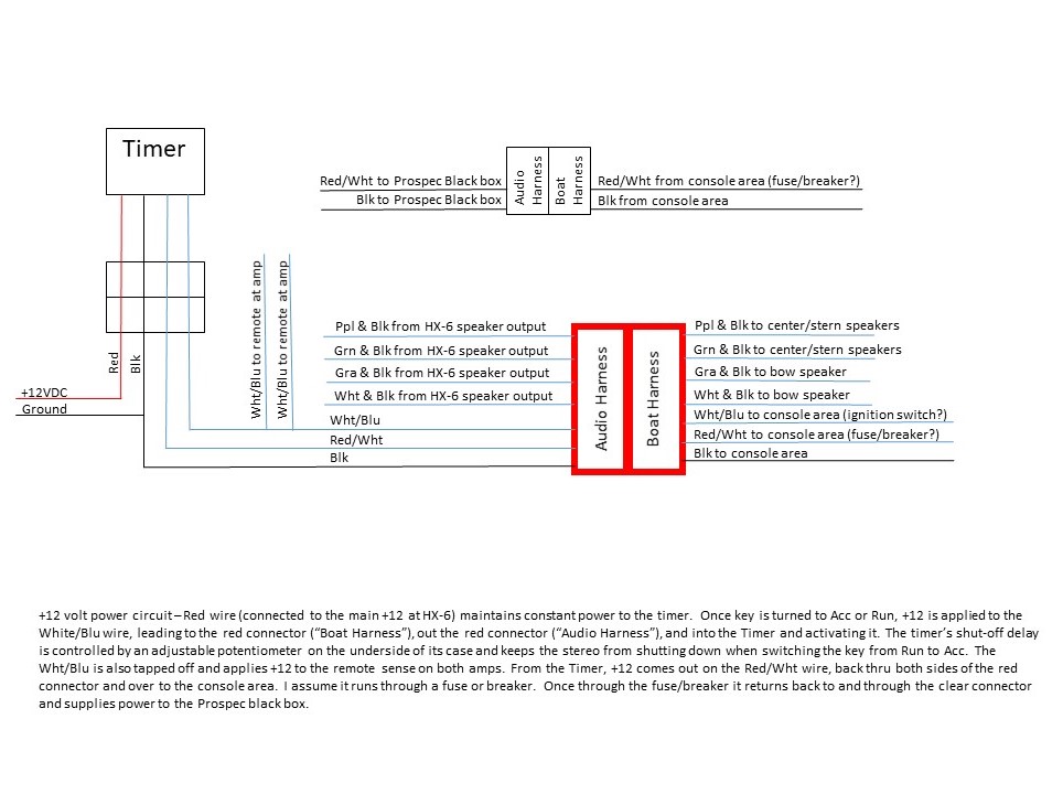

I made a schematic of what the factory stereo wiring looks like.
