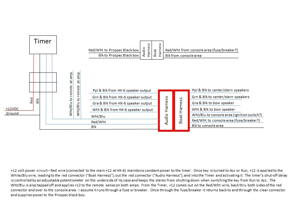

Factory SP2 seems to have the following setup.
HX-6:
- channel 1/2 - center and stern speakers connected in parallel (right left split) at 2 ohms.
- channel 3/4 - bow speakers at 4 ohms
- channel 5/6 - bridged to the sub at 4 ohms
HX-2:
- channel 1/2 - 4 tower speakers connected in parallel (right/left split) at 2 ohms 2 Amps.

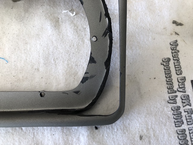

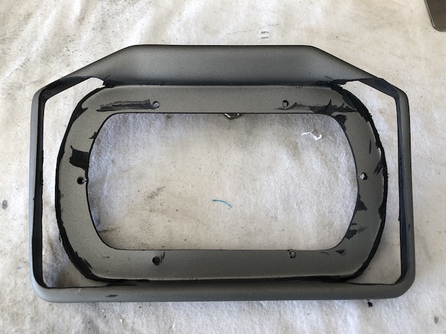

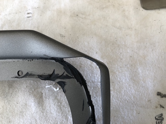

For the control head, I was able to carefully slowly cut the silver dash trim ring enough to maintain integrity in the plastic AND allow the controller to be mounted in it. I also had to use a scrap piece of aluminum to make the mounting bracket work.

I kept the timer circuit in play (nice option since the MC-1 takes a few seconds to boot up). The timer is located on the back side of the panel that the amps are bolted to. Since the MC-1 maintains all of its settings when all power is lost, i chose to tie the constant hot and ignition wire on the MC-1 to the timed 12 volts line. This way, when i kill the main power switch, the radio cant continue to pull power. The black box remote lines were used for the amps.
I made a schematic of what the factory stereo wiring looks like.
