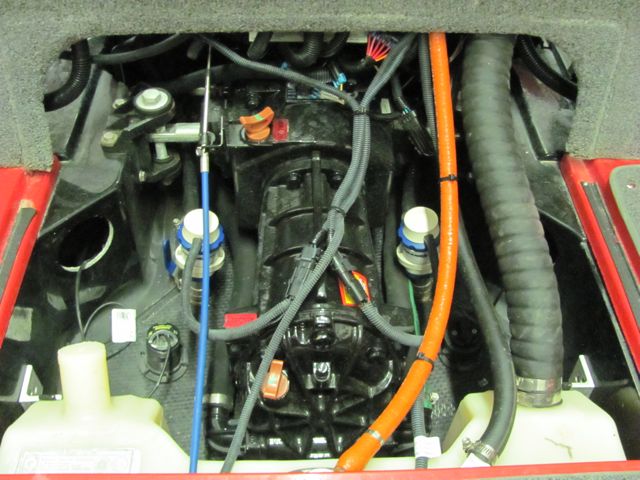

File comment: Start here, 90% of changing the seal will be done in this opening, If you have a prop puller now would be a good time to take it off, the shaft hangs down a little when you uncouple it from the flange, If not put a few towels between the prop and bottom of the boat so you don't scratch anything

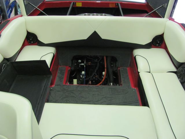

File comment: This is the v-drive unit, there are 7 bolts and 1 nut that you will have to remove, 2 of the bolts are on the bottom and can't be seen, feel for them and you will find them, make sure you remove all of them, when they are out the unit will easily slide away from the transmission, this unit also has 2 large hoses going to it, one from the water intake grate under the boat, the other goes to the sea water pump, I couldn't get the one on the right off the v-drive so I removed it from the impeller housing and took the whole hose off with the unit. There are four nuts and bolts attached to the prop shaft flange, remove these, I don't have a before picture but i'll point them out in the after picture

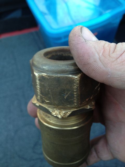

File comment: this is the housing for my original seal, you can see where the dealer got very rough with the jamb nut and used a freaking pair of channel lock pliers and a hammer and chisel on it instead of the proper tool.
