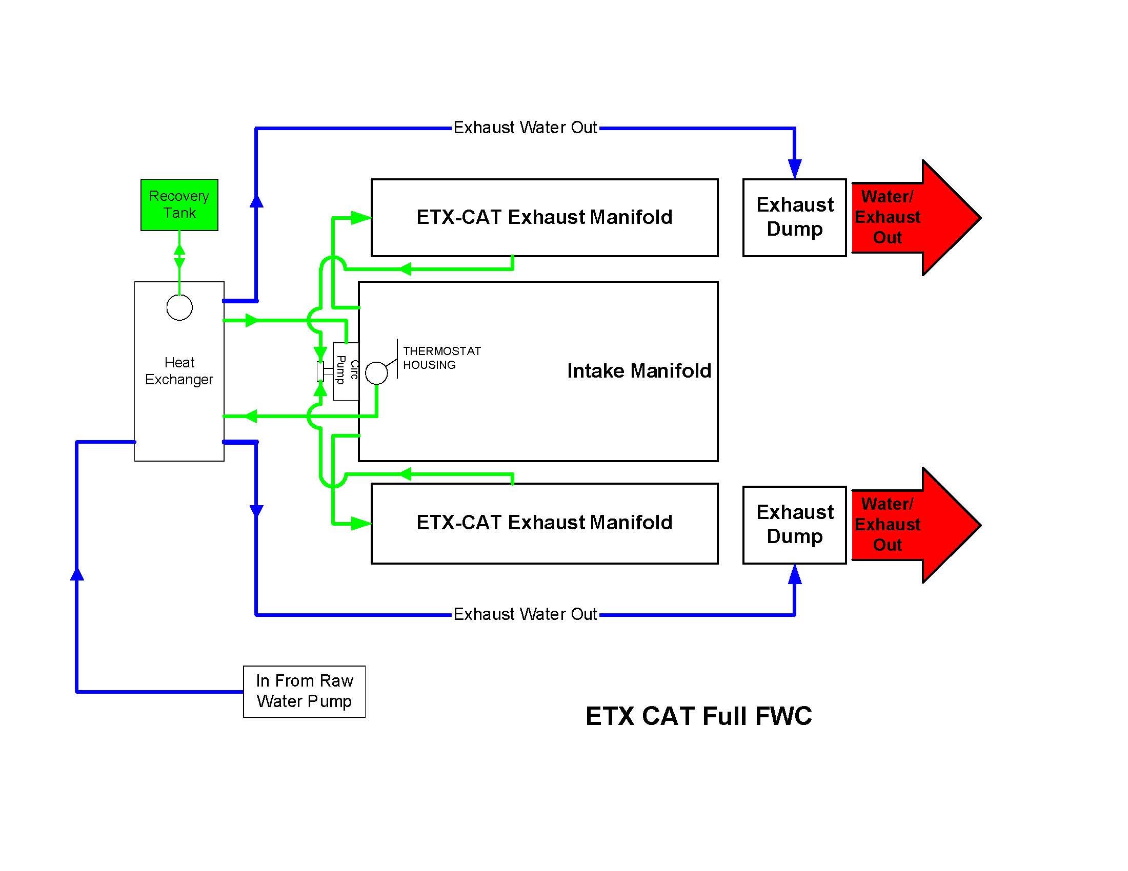

Really need some help on this one - I know there are some sharp Axis owners out there that understand the systems. Basically since I bought the boat in Feb '16 I have had 5 random overheats in two seasons and 200 hrs of use. I have the salt series Monsoon 350 with a heat exchanger and a full closed cooling system (CATs & block is cooled by antifreeze fluid). I know this system is different than most who have the raw water cooling system running through the block & CATs. See my note to Larry the service director at Indmar:

So that is the gist guys. Anyone have any other ideas to diagnose. The next step I am going to take is to shoot the temp of the CATs to see if one is reading significantly different then the other. If one is gummed up or blocked I can see it boiling over the propylene glycol fluid which boils at 370 degrees. The CATs get to 1100 degrees internally I understand. This issue almost seems like a design flaw....12-14 quarts of antifreeze can handle all that heat? Also check the circulation diagram I've attached.

 Post subject: Re: 2014 T22 350 SS Monsoon Overheating
PostPosted: Sun Mar 04, 2018 10:24 pm
Posts: 28
Me personally I'd try running a tstat 30deg lower or just take it out- or replace with fat washer
PostPosted: Mon Mar 05, 2018 1:28 pm
Posts: 437
Sounds like there might be air bubbles in the system. Put it in the water cold (or use a fake-a-lake) and remove the radiator cap from the heat exchanger. Allow all air-bubbles to burb out of the system and keep filling it with coolant. Once you feel satisfied that the air is out, cap it.
PostPosted: Mon Mar 05, 2018 7:25 pm
Posts: 457
Location: Mt. Washington, KY
Did you use the airlift to fill it after pulling suction?
Sent from my SM-G950U using Tapatalk
