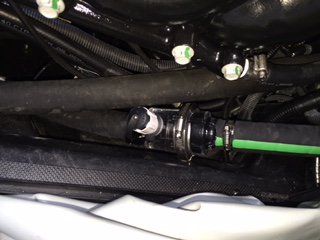

PostPosted: Wed Nov 04, 2015 7:32 pm
Posts: 72
I forgot to post a picture of the Perko Flush valve and installation. I hope to test out the hose connection and winterization in a few weeks. I want to get 1-2 more days on the water first.
