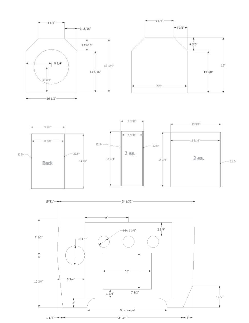

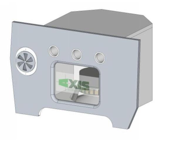

Ok so there are a bunch of great boxes out there and thanks everyone for sharing pictures. (I barrowed some ideas form a lot of the photos on this forum) I have a 2012 axis A-20 with a 2 vent heater and I wanted a 12” sub under the dash and a second hot tube in place of the vent under the dash. Here is what I have built and some of the drawings if you would like one of your own!
Info:
Sub : Rockford Fosgate P2D4-12
Box volume : +/- 1.79 ft^3
Ports: 3ea. 2” sch 40 PVC 8” long each (tuned to 40 Hz)
all from One 4'X4' sheet 3/4" MDF
I will post some photos of the install when I get it in, I am just finishing paint now.
Feel free to contact me if you have any questions! I can e-mail a more clear drawing but cant attach it here!
