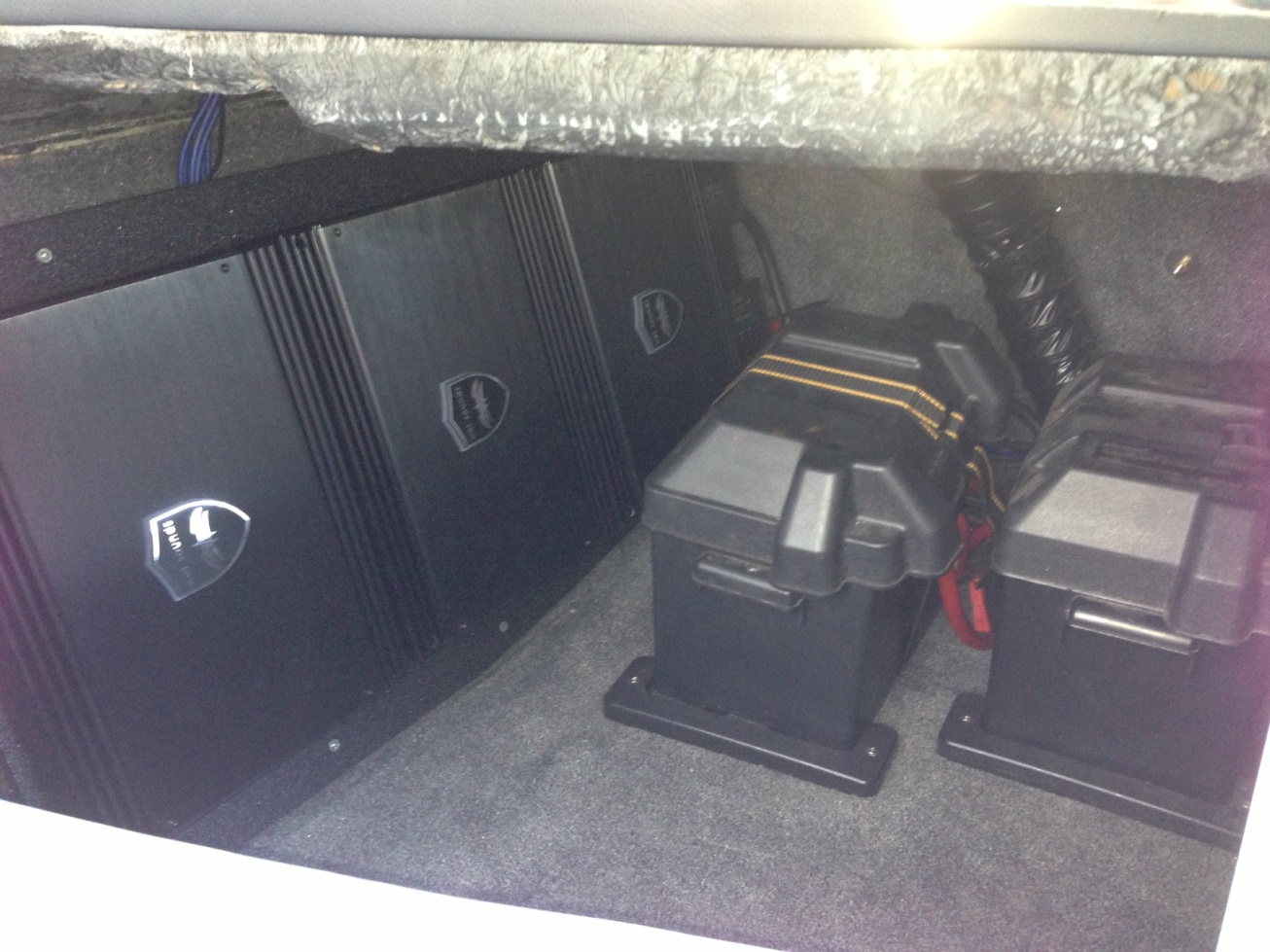

Since 3 is the maximum.

That's a super clean install. I have the same tower setup, ws xs650 for boats and arc amps. That tower has to be louder than hell. I would have been nervous to tune it because with amount of watts you're pushing (1250x1 and 685x2) anything set wrong probably would have blown the speaker.
Why didn't you go with the XXX 12" sub? Just curious due to everything else besides cabins being WS.

I chose my current sub becuase it was laying around in my garage from an old car stereo install. This sub is no slouch, it absolutely pounds and sounds incredible. Check out REAUDIO.com.
As far as the tower goes, it does scream, but I have the SD6 bridged to each tower. So each Rev10 is getting 685 watts and the Rev410 is getting 685 watts. Gain on the amp is only up about 1/4 of the way and it is very loud and clear!
