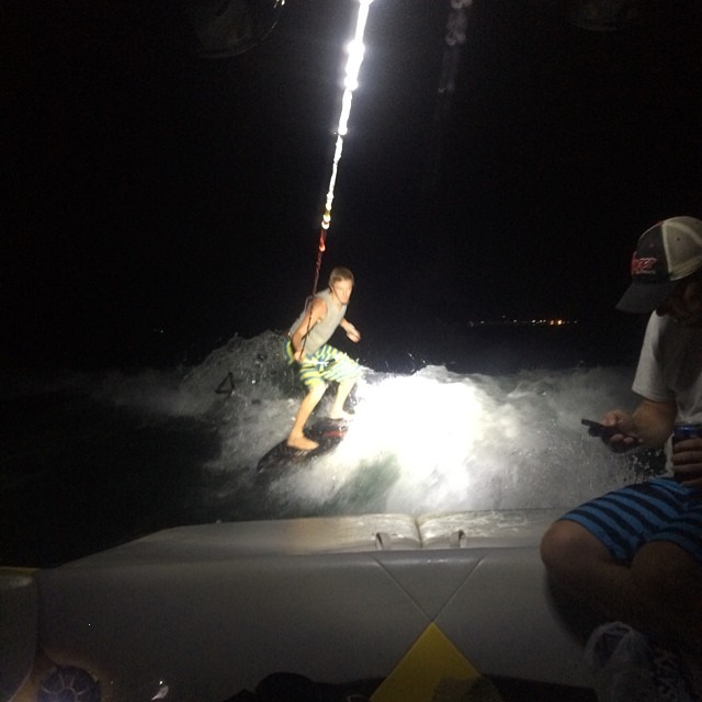

I just installed these Tuff Stuff Performance 10" Led- 12" Off Road Led Light Bar Flood/Spot Combo Beam- 3W Led-72W-4500 Lumen. . Got them off amazon fit perfectly and are really bright. They are the only light source in the second picture.

Just installed my light bar (the one linked above) between my two rev 10's. Its really bright, taking it out tonight I think to angle it in correctly and see how it does. I tied them to my underwater lights but put a switch in between so I could turn off the towers and just run under waters if I wanted to. Pics to come

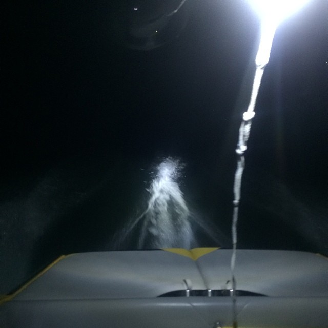

I installed mine by putting hose clamps around it and put some hot water heater tubing around it so it did not scratch the tower. I have a quick disconnect on the light using a 2 pin trailer harness so I can take it down or swap out if necessary. We put a switch after the on position of the underwaters and a relay from it to trigger the light. I can have underwaters on only or kick on tower light. I cannot run the tower light without underwater though. Here are some pics I means to post a while back. Sorry!
