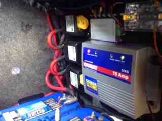

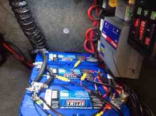

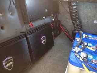

Installed the 3 batteries, an ACR & 2 remote switches to control it all.

Are you a wakeboarder or a partier? Nice looking install but I haven't found a need for that much juice yet.

What speakers are you torturing with that juice?

You don't have to be a "partier" to want/need batteries. Three Optimas isn't a lot of amp hours to begin with for a "party" set up but it is a good choice for reliable power with a small footprint in the storage area. 3 battery set ups are the norm. Two Optimas are a little over 100 amp hours for a stereo bank (I believe they also have a 75 amp hour battery) so I wouldn't say he has a lot of "juice". Bang for the buck, amp hours, and two batteries would be two 6 volts. That would be juice at 450-500 amp hours in only 2 batteries.

Are you using an onboard charger as well?

Ride or die.....jk. my opinion will change when he post his system. He is running top quality under the helm.

Anxious to see as well. W7 under helm maybe? SD6 is perfect for 3 some on the tower, but what the hell are the other 2 SD6s powering!?!? We need pics!! :D
