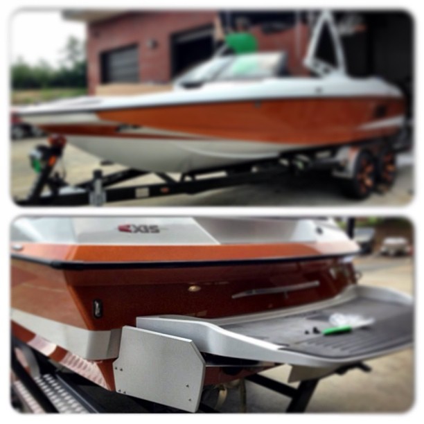

Here is the pic of the new surfgate for Axis. As expected, you cannot order this from Malibu/Axis and there are no retrofits avaliable as platform, wiring and computers are different for 2014. I am going to try to retrofit a basic surfgate with trim tabs mounted sideways and a simple left right switch. I'll prolly integrate a check light if a tab it deployed so we dont rip it off at faster speed.

It is very common to install trim tabs on the bottom of a boat's transom and use them throughout the speed range of the boat. I can not see a properly mounted one ripping off at speed.
