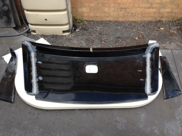

Platform cut down & glassed back together
File comment: Cutdown platform

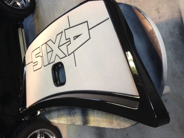

Finished platform

Carbonfiber surf gates finished

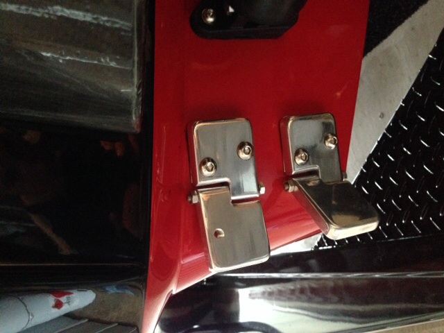

Billet alloy hinges.

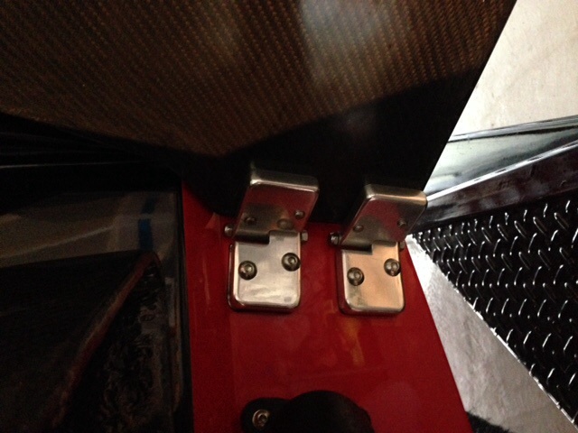

Mounting hinges

Mounting gates

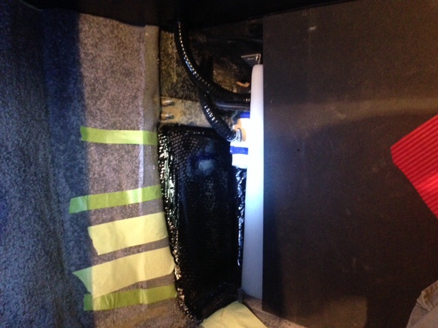

Put 2 extra layers of glass around actuator & hinge points. when drilling into hull found it to be over 3/4 inch thick ,had to order longer button head bolts. Do not believe that the hull is any different all the way up to 2015 for A22 .
