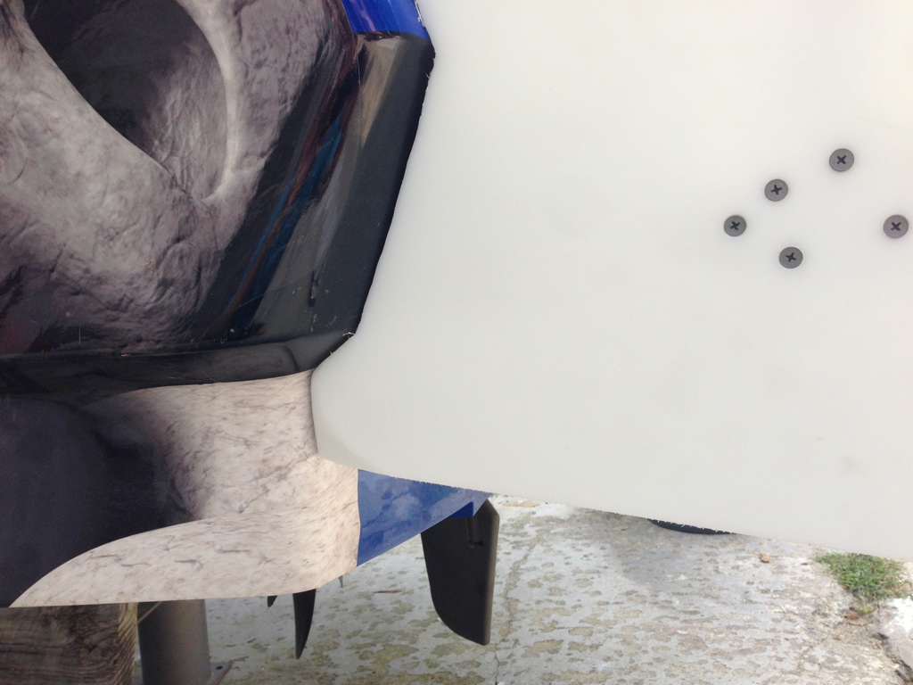

Fit it flush as well...

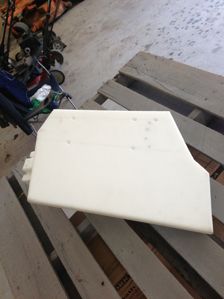

Finished product...

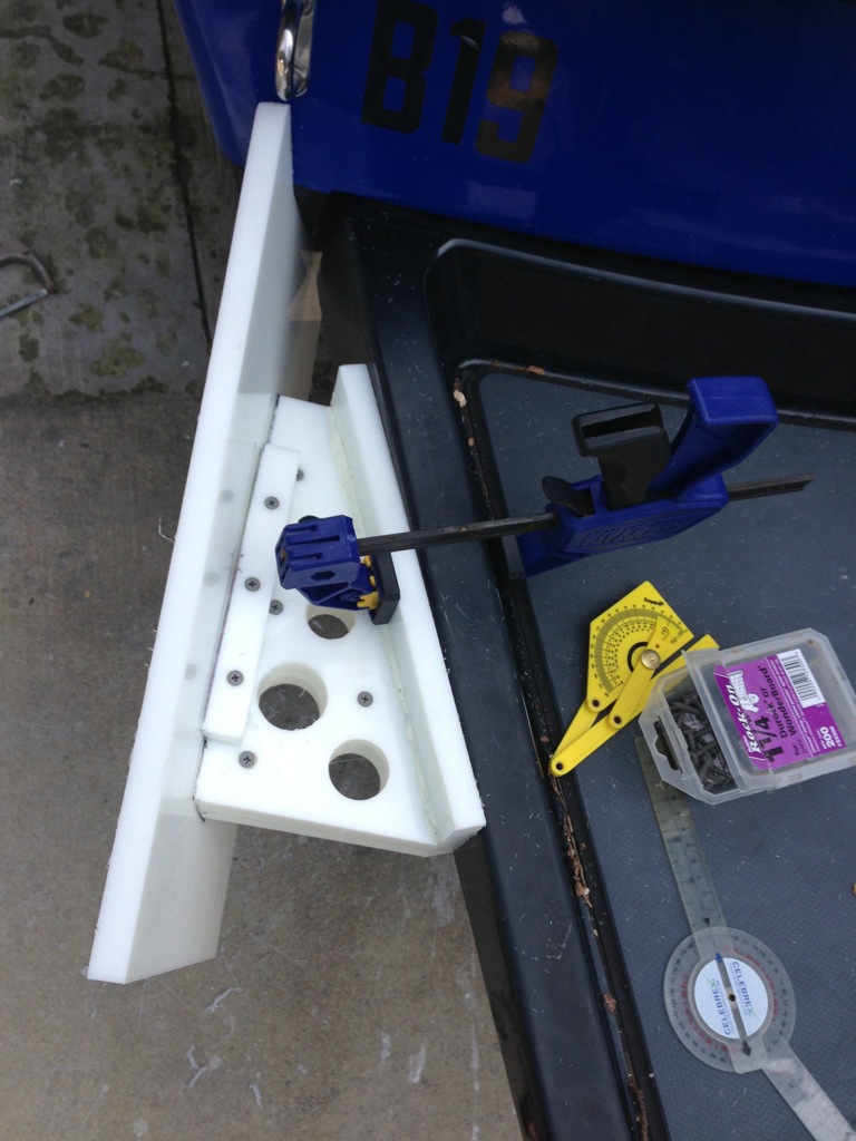

Beautiful! Can you give those exact dimensions/angles, cuts etc? I want to make my next ones at those exact specs.
 Post subject: Re: Home made "Poor-gate"
PostPosted: Tue Aug 27, 2013 5:59 pm

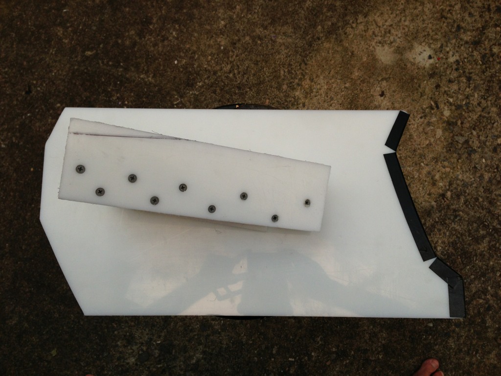

Posts: 276
Hard part will be getting the angle the paddle is mounted at. I angle that a lil to replicate the angle of the true surfgate when its deployed. I just cut the paddle to fit the hull then clamped the mount into position and drilled into place. I piloted each screw tho.
PostPosted: Tue Aug 27, 2013 6:01 pm
Posts: 276

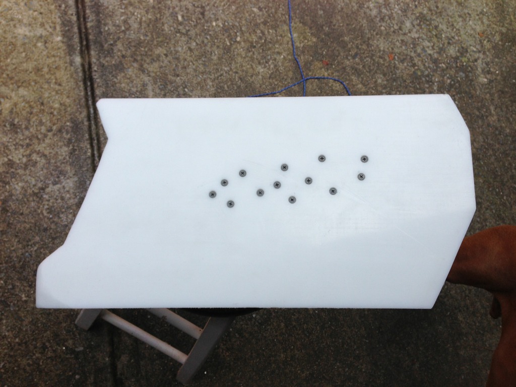

And the paddle size was the 12"x24", 3/4" thick high density polyethylene I ordered from amazon w the notch cut for the hull and the top and bottom corners cut to mimic the stock surfgate.

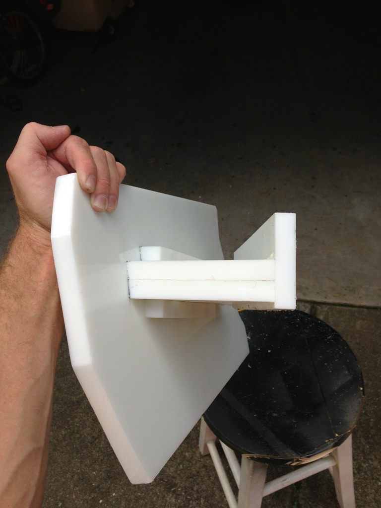

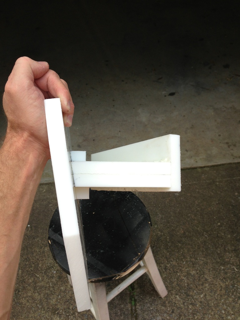

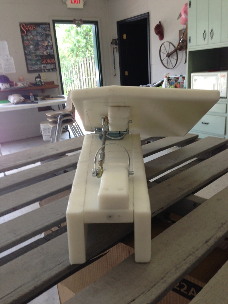

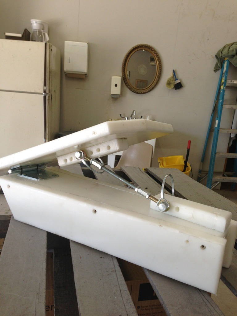

So I wanted my gate to be adjustable to different degrees and to close up for Easier storage
