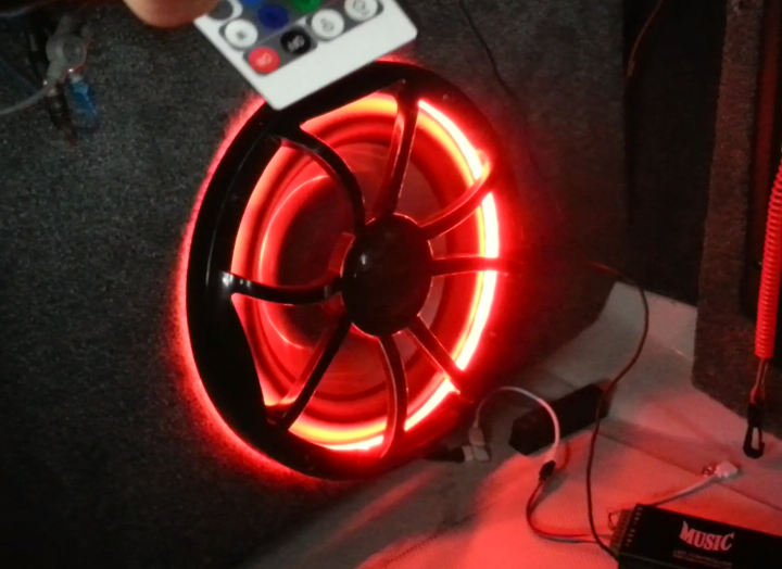

Wetsounds sub done ... 10 speakers and 16 cup holders to go!
I chose RGB, added a music controller, wired into the ACC switch.
The LED ring is 1/2 cast acrylic.
I've found I'll be soldering a 12" wire lead onto each LED rather than adding multiple snap connectors onto each LED then again another connector onto the main feed.

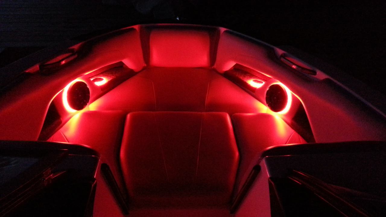

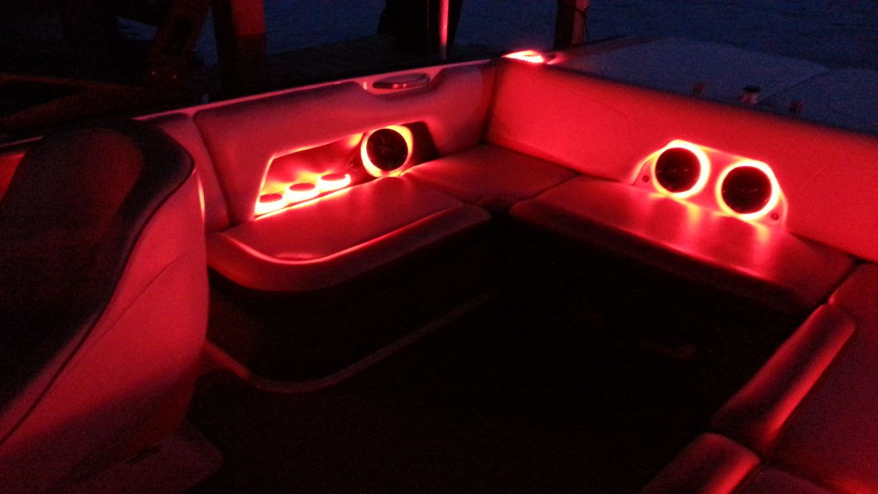

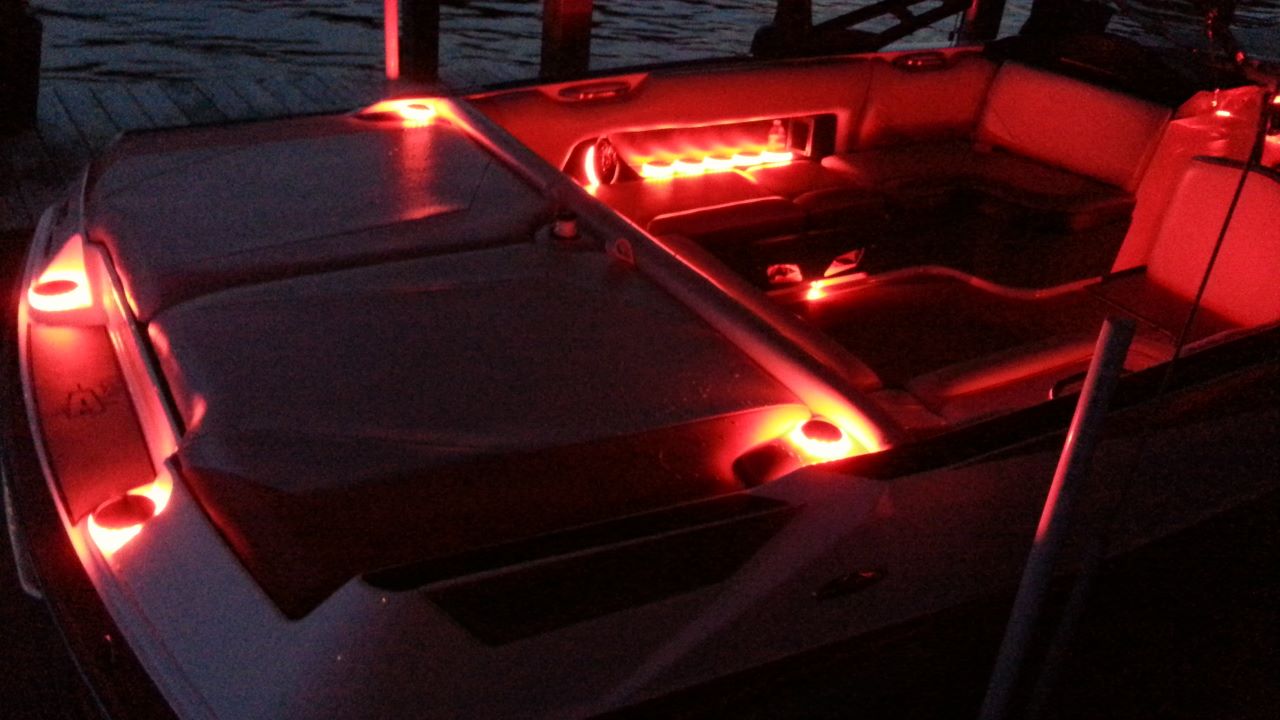

They're RGB with a music controller ... still need to do the REV410's in the tower and the transom sony remote
10556912_10203482663899146_4175523730578003361_o.jpg [ 78.07 KiB | Viewed 33327 times ]

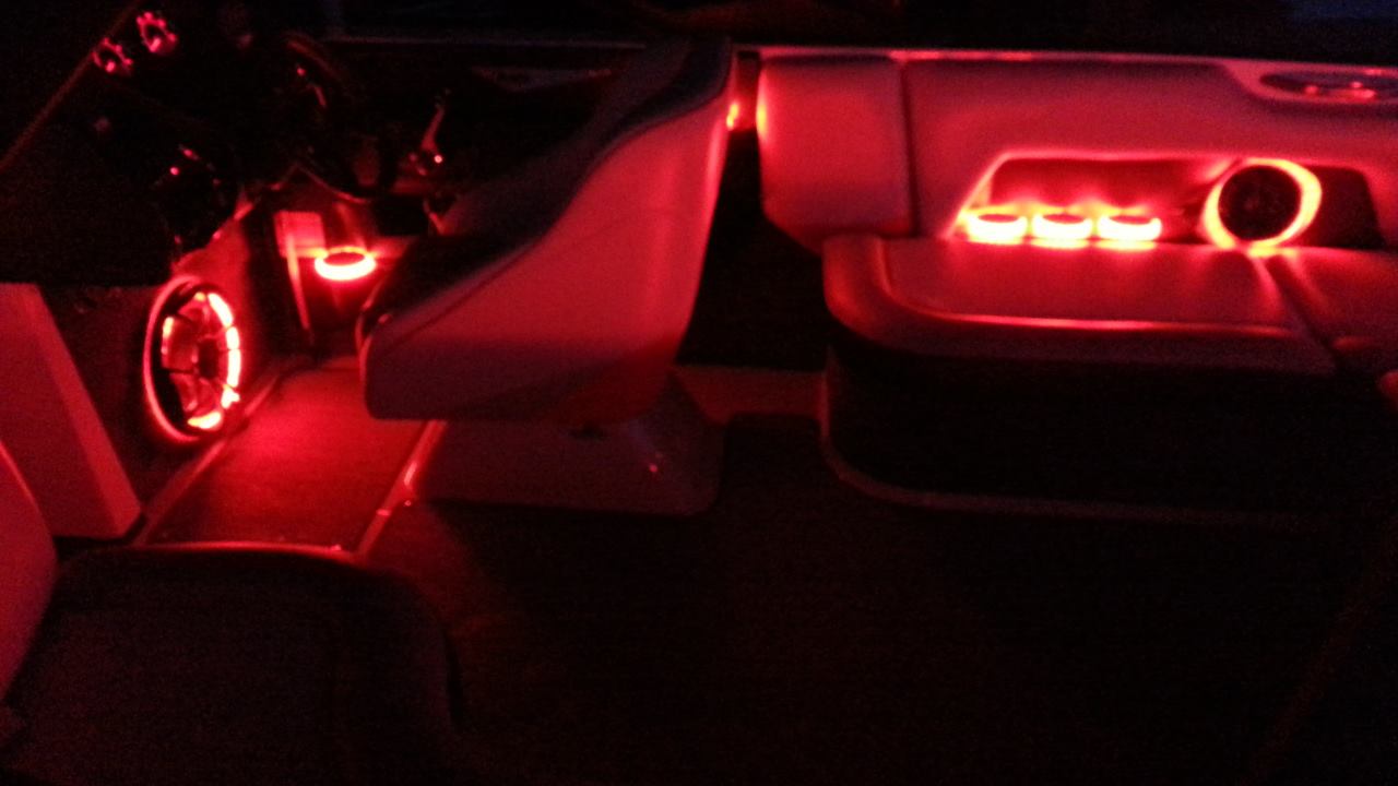

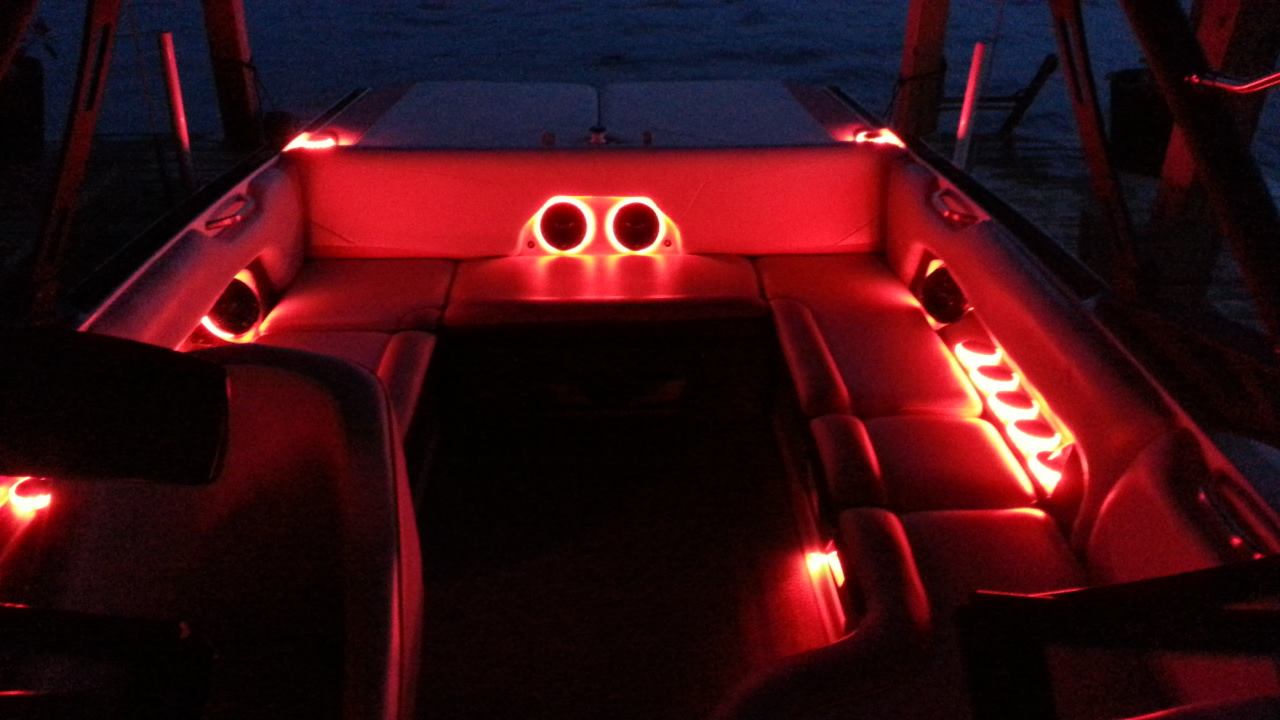

few more pics .... there's a special piece for the rev410s needed, that's on order. an rgb 6 way connector.
1890483_10203482666419209_8967501247111618872_o.jpg [ 102.44 KiB | Viewed 33327 times ]
