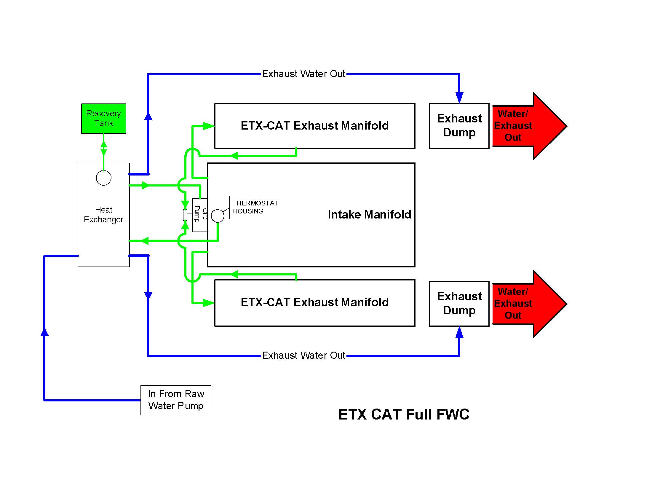

Really need some help on this one - I know there are some sharp Axis owners out there that understand the systems. Basically since I bought the boat in Feb '16 I have had 5 random overheats in two seasons and 200 hrs of use. I have the salt series Monsoon 350 with a heat exchanger and a full closed cooling system (CATs & block is cooled by antifreeze fluid). I know this system is different than most who have the raw water cooling system running through the block & CATs. See my note to Larry the service director at Indmar:

So that is the gist guys. Anyone have any other ideas to diagnose. The next step I am going to take is to shoot the temp of the CATs to see if one is reading significantly different then the other. If one is gummed up or blocked I can see it boiling over the propylene glycol fluid which boils at 370 degrees. The CATs get to 1100 degrees internally I understand. This issue almost seems like a design flaw....12-14 quarts of antifreeze can handle all that heat? Also check the circulation diagram I've attached.
Thanks for reading this entire thing!
Josh

Me personally I'd try running a tstat 30deg lower or just take it out- or replace with fat washer

Sounds like there might be air bubbles in the system. Put it in the water cold (or use a fake-a-lake) and remove the radiator cap from the heat exchanger. Allow all air-bubbles to burb out of the system and keep filling it with coolant. Once you feel satisfied that the air is out, cap it.

Did you use the airlift to fill it after pulling suction?
