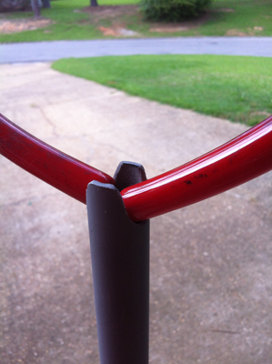

Yeah it's actually really easy to do. I just got a 5 ft piece of PVC pipe that I fed the rope through. I cut a notch in the top for the handle to sit in so that i could hold it flat. I duct taped the handle to the PVC and bought a handlebar gopro mount that I attached to the other end. It looks really awkward but you don't notice it when you ride! I fell quite a few times at first because I was focused on not making a stupid face instead of riding! Haha

Yeah, the notch was for the V part of the handle. The V will keep or from spinning. The duct tape keeps the PVC from sliding down the rope and it also keeps the handle in the notch. I'll take some pics tomorrow!

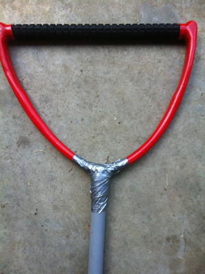

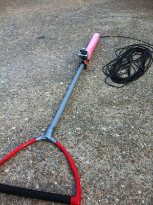

OK Gang. Here is my set-up with the GoPro. Really easy to do.
Section of PVC conduit cut down to 4'. May actually cut this down further once we get some shots and get camera at a proper distance. Right now we are at about 3' from handle V.
Used my Dremel with the sander attachment to make the V section for the handle to fit into.
Duck tape to attach handle.
Swim noodle on end for flotation.
GoPro handlebar mount to attach to PVC.
Will post pics after this weekend.
