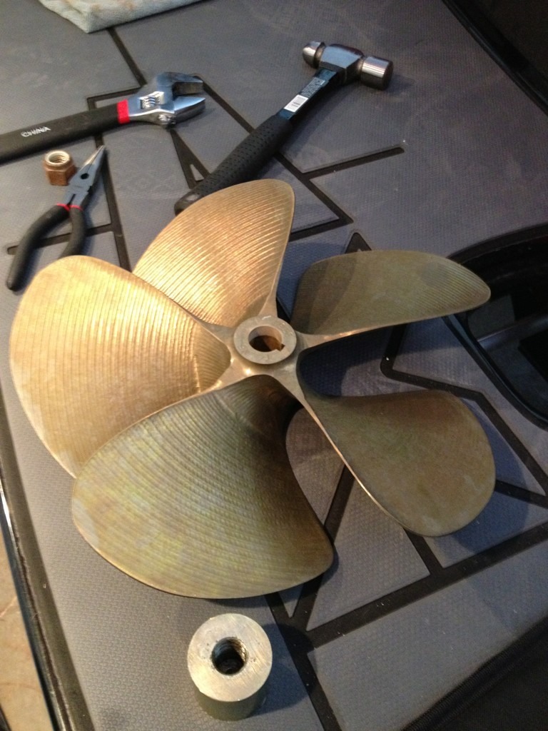

If anyone is interested In knowing I just purchased the Acme harmonic prop puller and tried it out on my OJ 5 blade. The prop had been on the boat since we had the group buy, so I think 18-24 months. It did thread on all the way up to the prop flange so I used a broken piece of the cotter key and put in there to act as a spacer, instructions say to have a small gap, I gave it a couple of good smacks with the hammer and it popped right off, I didn't want to heat it up or beat on it from the back side so I found a video of this puller online and thought I'd give it a try, I was very skeptical but it did have good reviews, I'm a believer now, I'll keep this baby in the back of the truck from now on. Here's a link to the one I bought, thanks ED
The reason I removed it is to use on my friends tige that we just finished replacing the underwater gear, a 14" prop is the biggest his boat can handle hence using the OJ instead of my 1235 or 1615
