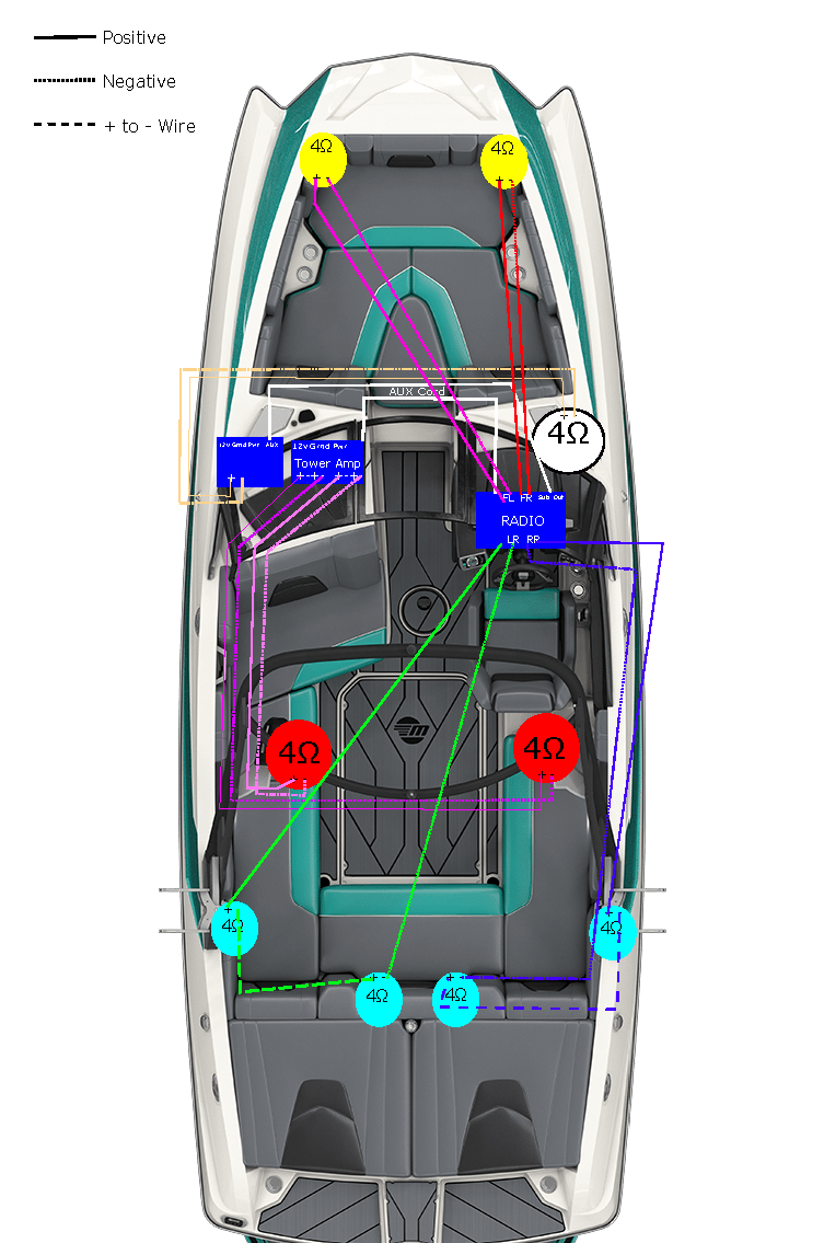

We are redoing the aftermarket stereo system on our 2012 a22. I developed this basic (honestly even a little crude) wiring diagram for our installation. Any thoughts? Thought this may even help anyone else looking at working on their a22. PDF file is attached below.
 Post subject: Re: 2012 A22 home made wiring diagram!
PostPosted: Wed Jun 02, 2021 6:54 am

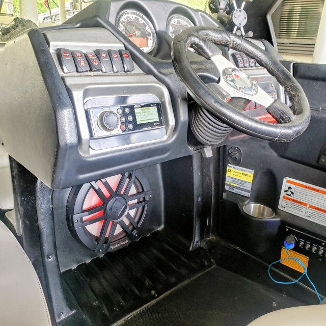

Nice diagram. You only have two tower speakers? My 2010 A22 has similar speaker layouts, but 4 tower speakers (2 channel @ 2ohm) and all the speaker wires run to the passenger side closet. Two 4 channel MTX amps in there and the original 12" sub. I have since moved my factory sub from the closet (dumbest design) to the drivers footwell.
