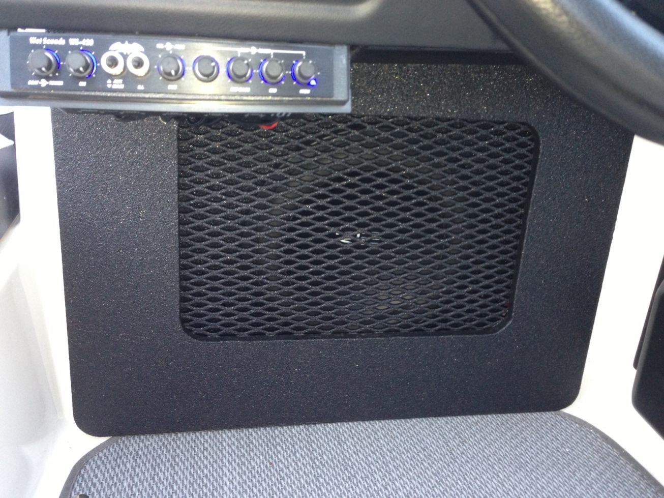

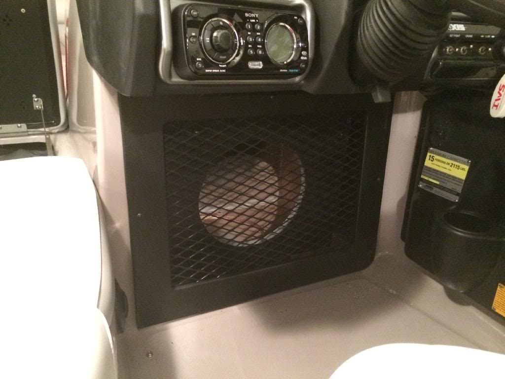

I took a couple pics out of the forum here hoping to see how these were made? More so what material do you think its made out of? Assuming its some kind of plastic, where would you buy that?
One of these is bolted and the other has no bolts showing, so curious if anyone knew how it was secured?
No intention to steal anyones photos, but just wanted some ideas how to replicate what they did

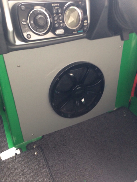

I did this the other day. The sub is a false front. I just put the tented screen behind the grill. I got a yard of vinyl that match and covered the board. Super easy and super cheap

1/2" birch plywood with a sealing primer and bed liner sprayed on. The grate is expanded metal that I coated with bed liner. The tricky part was getting the right bottom corner to sit flush. Originally I bolted the face on but ended up going to Velcro. I also added subwoofer cloth to hide the cavity and sub.
Btw, mine is the first picture. Sorry I didn't see this thread earlier.
