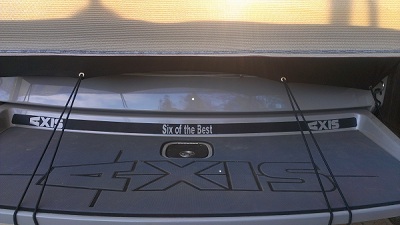

I just installed deck trac to my Axis. Bought some water proof ruberized deck grip tape from my boating store for $27 and got the kids to cut out some letters. It does the job and looks sick.
