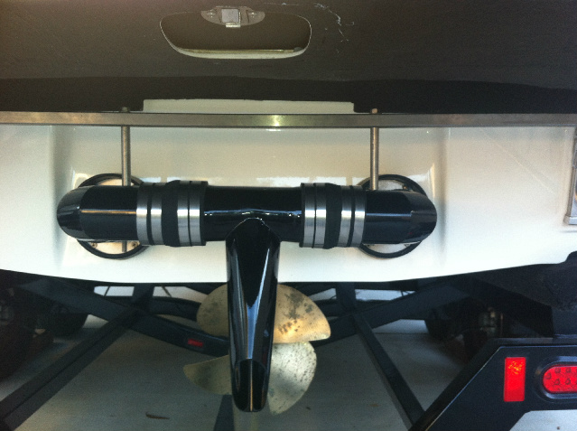

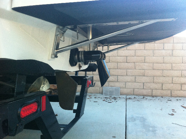

Hey guys, I installed my FAE system on my A22 today.
First off, I did it during my children's 2 hour nap. I could have done it a lot faster but my drill bits are done and it took a bit of work to drill the holes. I have a step bit which was very helpful, definitely recommend getting one for the install.
I do not have the wedge, so this looks different than most Axis' will, but the install will be almost as simple. The instructions are simple and easy to follow, and the system is very very sturdy once it is all tightened down.
I went with the standard black powder coat finish. They have a chromed finish for a little bit more. I will hopefully be going out this week sometime to test a few things. My 2 concerns is that it will affect or mess up my wakeboard wake, or it will reduce some bottom end power and make it more difficult or impossible to get on plane when I am slumping...
I will update after I go out.

Okay, took her for a test drive today.
Overall: awesome.
I loaded my boat up with 4800 lbs, 2 toddlers, 2 adults, and 1 rider, reproducing the exact same set up the last time I rode without the FAE. This set up will not get up on plane with the cinco unless I drain a bit first, but the 1235 did it pretty well. With the FAE installed the 1235 did it without draining any ballast, but it took a little bit longer to get up on plane... 5-10 seconds maybe? Riding with normal ballast of 4k I did not notice any bottom end/hole shot loss of power.
It definately is quieter than before. I have the california mandatory CAT motor so it was not too loud in the first place, but it is even more quiet now. I would not say 1/2 of the noise level like others claim in their boats, but I would say that it was cut by 1/4 or so. I think with the Cinco prop and the FAE, it would be really quiet.
Wakeboard wake was unaffected, no change in rooster tail, no weird sprays coming off the back of the boat, and it was so much quieter for the rider.
Wakesurf wave was not, and will not be, tested.
I took it for an initial test run while filling ballast and then checked to see if it was still solidly on there and it was, then after each rider I checked again... solid all day.
I did not notice any change when driving or turning, other than the quietness, I would have had no idea it was back there.
I am stoked and will definitely be keeping it on there for the foreseeable future.
