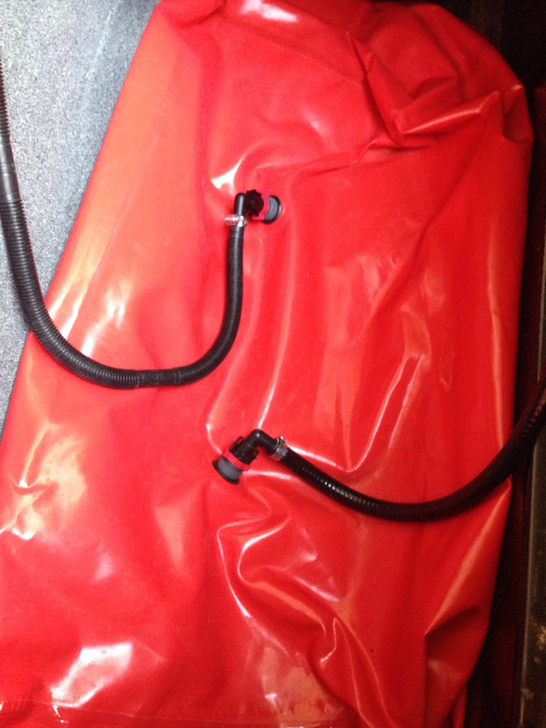

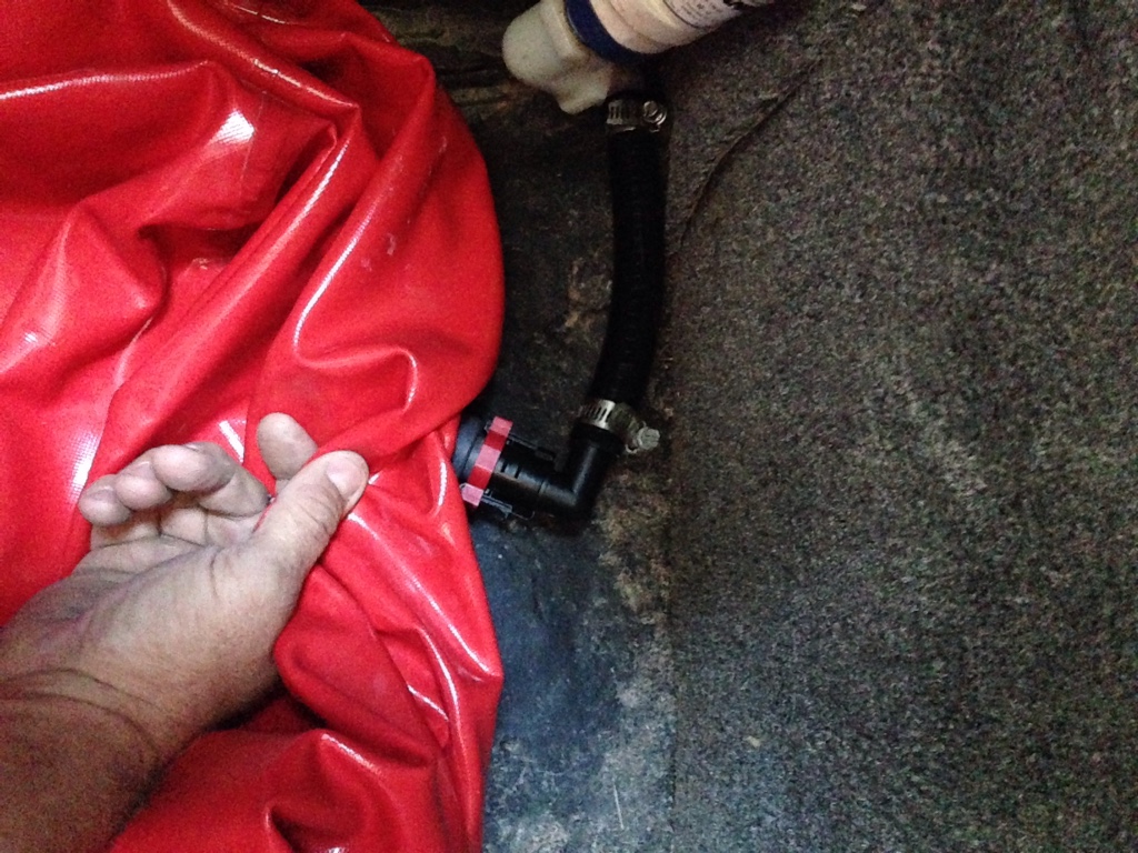

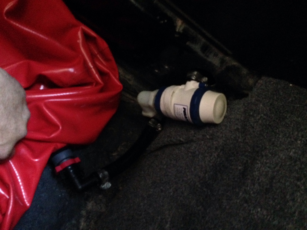

Here is mine after hooking up the original tank vent to the bag, and I got the quick connect fitting to hook up the drain pump to a bag fitting, screwing the pump directly in the bag had a small leak due to there not being an o-ring seal on the pipe thread fittings, boat stays dry now!
