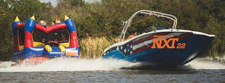

[attachment=-1]uploadfromtaptalk1429212923594.jpg[/attachment]

There are two ropes on that bouncy house. One to the tower and a second to the transom. The transom rope is taught.
