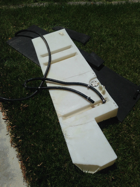

Here is the starboard side hard tank pulled out, along with the 3/4" fill hose and 3/4" drain hose. I did not change out the vent line because 3/4" vent line is plenty.
If you look in the middle of the hard tank, you may see my cuts, I used a electric jig saw to cut horizontally across the tank, was able to rotate it just enough to cut down the side a little bit... this was enough to allow the tank to flex so that I could pull the tank out.
I removed all the tanks fittings, the elbows for the fill and overflow, and the elbow for the drain. I tried for an hour to pull it without having to cut, so sunday when i pull my port hard tank, i will just cut it right away.

and the big hole at the bottom, that area of the tank sits under the floor in the corner seat area. I tried to cut this corner off to get clearance to pull it out. It did not work, so then I cut the middle of the tank to finally get it out.

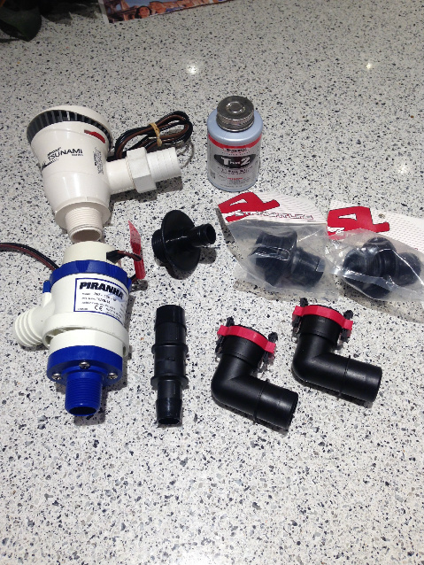

here is a picture of all the parts needed to do ONE side only, minus the hose. I have a parts list from my order, pm me your cell number or email and I can send you a copy.
