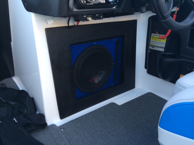

finally finished mine... looks great and doesn't vibrate!
1/2"mdf
sealed with resin
sprayed bedliner
secured with velcro
Thanks for all of the tips.

idahosurf wrote:
1/2"mdf
sealed with resin
sprayed bedliner
secured with velcro
Pics or we don't believe you :D
lol... in this pic you can see the speaker more than you can in person.
this set up sounds great. I paired the type r with an alpine 1100 w amp
