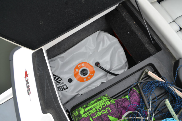

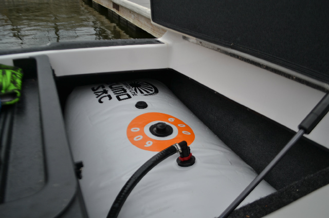

As for the Straighline Sumo series. I rode today and tested the 600 sumo. Short story, it is a great sac and perfect for the A20 or A22 owner who is looking at the 400's or 750's. If you plan on being a serious surfer and are looking at the 1100's as an option, then just get the 1100's. But if you are looking at the 750's, I say get the sumo 600's.
They have 2 drain holes and 2 fill/vent holes plus a big center hole that is the burp hole/ fill hole for the tsunami pumps. So in total 5 holes. They come with 4 90deg threaded PNP quick disconnect adapters like the fly-hi system has. They thread in real easy, hand tight, and they did not leak. The pnp quick disconnects that I currently have worked on the sumo sac exactly like the fly high. It took me about 20 seconds to switch out my 750 for the 600. As you may know already, the flyhigh 750's are too long for the rear lockers, so they stick under the back seat bracing and hose/wire carpeted cover. My 750's get smooshed in the front causing the rears to stick up a little bit, making them look like a wedge sack. Their is a little bit of air tapped in there unless you burp it once it's almost full. ( No big deal, only a couple gallons at max) If the 750 rating is correct, then I would guess my sacs are around 700 when completely full. The 600's fit perfectly. they fill up completely and do not put pressure on that front hose/wire cover and do not get pinched off. (there is an L bracket with a screw at the bottom of both hose/wire covers that put pressure on my 750's and I can see the mark where it hits, so far no leaks) The 600's were about 2-3" taller in the back and came up to about 2" from the bottom of the locker edge, the 750's are about 4" from the bottom. The front of the 600's are just as high, but the 750's slant down in the front because of the cover. If the 600 rating is correct, then they are 600 lbs in the locker as they fully fill and expand. Another good thing about the 600's is that it does not take up any of the rear bench corner storage like my 750's do.
Now for the wake: I ran full ballast today except I switched out ONE 750 for one sumo 600. I also ran my 800 lbs floor sack (that is dope by the way :D ) full fuel, 3 adult males, 1 child, gear... etc. When filling the rears, the side that had the 750 in it filled first by 30-60 seconds. If my pumps are equal, that would lead me to believe that the 600's actually hold more weight. However, I do recall that one side usually fills faster than the other side and I do not remember which side it is. Even so, if the side with the 600 normally fills slower, then there was no change in fill times over the 750's so they weight approx the same. If the side with the 750 fills slower, then the 600 sac holds a lot more water than the 750.
Once the boat was completely full, it sat perfectly even from left to right, and when riding behind it, the wake looked normal and we did not have to shift people or lead to clean up the 600 side. I would say that they are almost exactly the same weight.

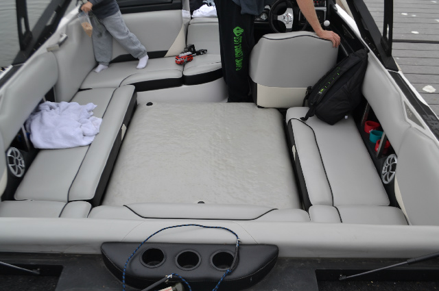

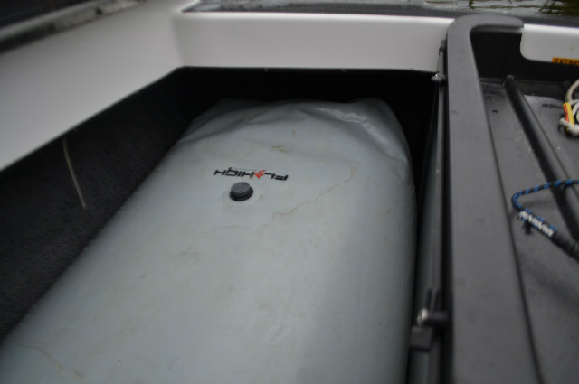

a few pictures of the sacs and setup
File comment: sumo 800 floor sac, ballast porn for you all

File comment: sumo 600 filling

File comment: fly high 750's filling up

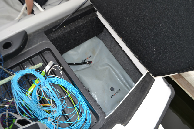

more
File comment: 600 full
File comment: 750 full
