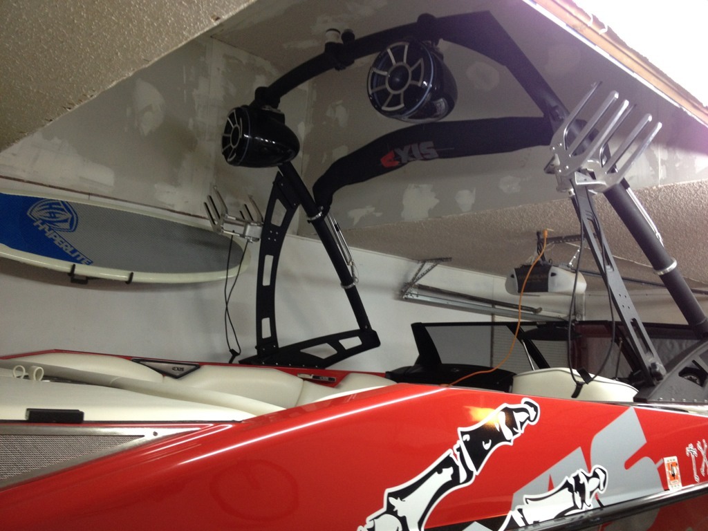

They are big and will occasionally be in the way but they are hard not to notice and well worth it, if you get the amp set up right they will sound good on 300, the WS amps are a little underrated, I run a syn4 and tuned it on an o-scope to 430 watts and they sound great while riding, a friend of mine has 2 rev 10's on his tige on a PPI amp pushing 310 watts tuned and they sound good too, I was skeptical dropping that much cash on 2 speakers and an amp but after using them I wish I'd done it sooner!!

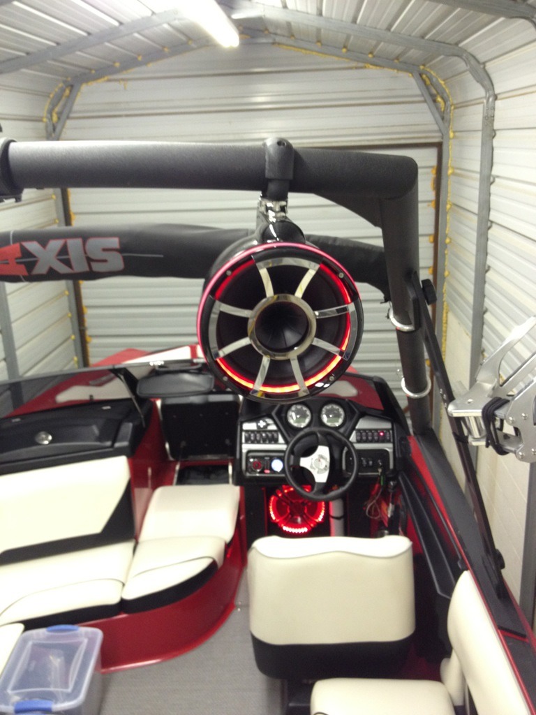

If you get the quick release clamp be sure to remove the bolt and taper the last two threads, if you don't they will get mashed in the radius of the clamp and tear up the threads the first time you try to remove them, I caught this on my buddies speakers and luckily we didn't damage anything, someone on wakeworld just went through this problem, I tapered mine before I ever installed them and have had them on and off 30+ times with no issues

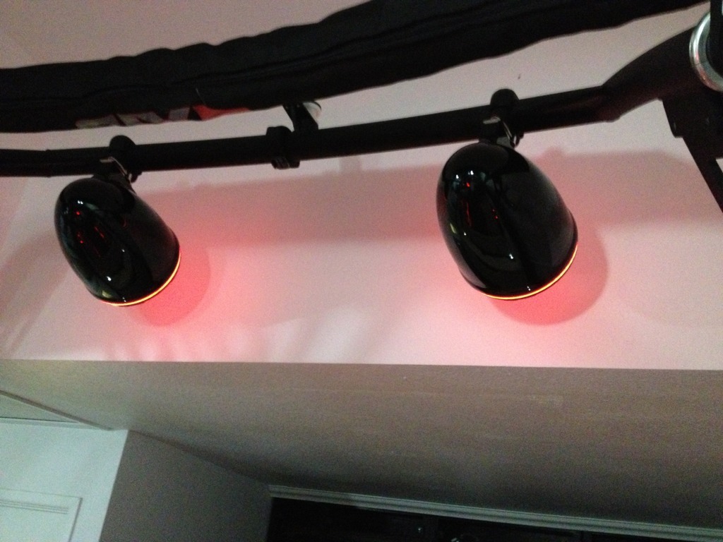

Walter -- did you build that custom "tray" ceiling for your tower in your garage? too funny!
-aha-
18 Monterey 278SSC
 Post subject: Re: Running only a pair of Rev 8s or Rev 10s - pics please!
PostPosted: Tue Apr 02, 2013 9:38 pm
I did, there was a bunch involved, I had to restructure the ceiling supports, move a wall, jackhammer the floor in the laundry room,move the plumbing for my washer and dryer, build a new attic access hole and then I redid all the drywall in the garage, it was part of a kitchen remodel that I did and just kind of threw In the garage and water well makeover at the same time, I figured while the house is thrashed I may as well fix everything, the boat stays cleaner in the front garage than the metal building, and the temperature is a little more regulated. The truck will have a new brick shop in the back yard here in a month.
