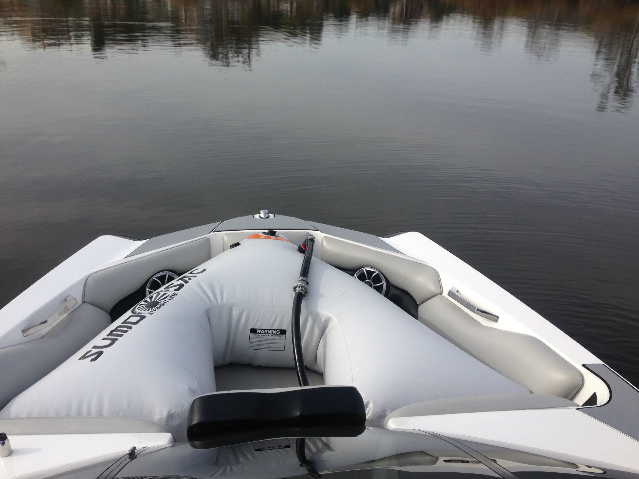

ThatGuy wrote:
Looks great.
So how do you do this? Did you add extra lines or just add length to the current lines? Do both bags fill/drain at the same time or is it one then the other?
Thanks for the pictures!
I ran an extra long ballast hose from the "front" ballast fill pump that fills the mushroom sack, long enough to reach the new top bow sack (an extra 5' feet or so) The low drain port on the top bow sack drains through a 1" hose (approx 4' long) into the mushroom sack. When I hit "fill" on the front ballast switch, water is pumped into the top of the top bow sack, drains through into the mushroom sack and fills the mushroom, as that sack gets full, the top sack fills. This is how the rear plug n play is set up. So when I hit "drain" on the "front" ballast, water is pumped out of the mushroom sack and gravity drains water out of the top sack into the mushroom sack. I do have to go up there and lift the left side of the U shaped sack to get all the water out, and if I would have gone with a triangle sack I would not have to do this.
When I do not use the top bow sack I hook this long ballast hose back to the mushroom sack, in its original position, and it just has a big loop of extra hose, as seen in the pictures. I can fold up the 750 bow sack and the 4" hose really small and put it in my lockers or under the seats when not in use.

Here is another picture of the bow bag completely full. I had a hard tome keeping it full on my test run because the pressure of the water of the top bag would push water out the vent and drain lines of the bottom bag, so it was constantly draining when boat was at speed. I added a $5 pac ball valve to the 1" line between the top and bottom bag. Once the bottom bag is full, I then close the valve and top off the top bag. I leave this valve closed until it is time to drain. It worked perfectly, now the bow sack is completely full and they do not drain on their own.

Im around 4500 lbs and no wedge.
Sumo 900's in rear lockers, 100 lead in each rear locker under the sacks, no more hard tanks = 2100 (guessing that these 900s fill to about 950 in the lockers as they fill to 1000 when completely full)
150 lbs lead behind driver under bench seat all the way back, 250 opposite that under bench seat all the way back = 400
center hard tank full = 500
sumo 950 arrow sack under bow = 700-750?
sumo 750 bow sack on top = 800
I barely surf. Have surfed my boat a hand full of times, but none with my new set up. Old surf set up was no wedge (cuz I do not have one) all hard tanks full, sumo 900 full on surf side, 600 lbs lead in bow. Riding around 10.8 i think. Wave was very rideable and friendly, but nothing to write home about.
