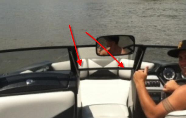

Going to install some cabin speakers in my 2011 A20 myself and just wanted to ask a quick question.
The 4 speakers in the middle seem like they wont be that hard, it looks like i just have to put a little cut in the vinyl and push the speaker through.
Im worried about the front pair but, My front cushions are thick and when i look at fotos of others peoples rides, it looks like ppl have a half cushion, i have included a pic of mine?
Has anyone done this before? If so, is it a hard job, did you have any issues with it?

File comment: Just worried bout the front

There is that thick black plastic backing there, and a hole for your front speakers behind the vinyl and foam. You can cut through it. I had to use a hole saw and go through the fiberglass, too, as my speakers were deep (Wetsounds). Having said that, the A22's are different, in that the rear speakers are in the fiberglass, outboard more, so I was cutting holes, anyway.
