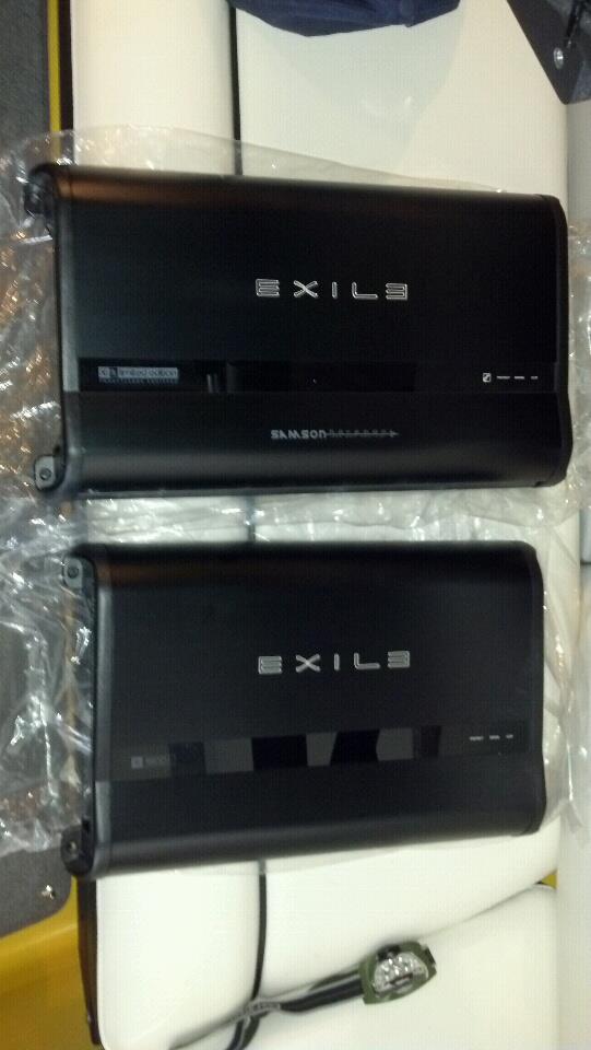

Boat is finally home! Madden voyage tomorrow... then stereo install begins!!!

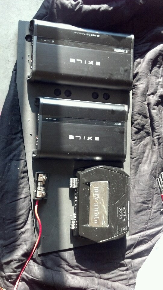

Finally got the boat home this weekend! After taking it for a cruise up and down the river got home and pulled out the amp rack to get this project started. Does anyone know the quality of the RCA cables from the factory? They didnt look bad and I dont want to change them if that is the case. Any way more to come.

Looks good! If you can swing it, I'd recommend the new exile eq or wetsounds 420 for some zone control. You'll find that your towers will drown out everything when the main volume is turned up without control over them. I think exile is still offering their discount promo on the eq.
