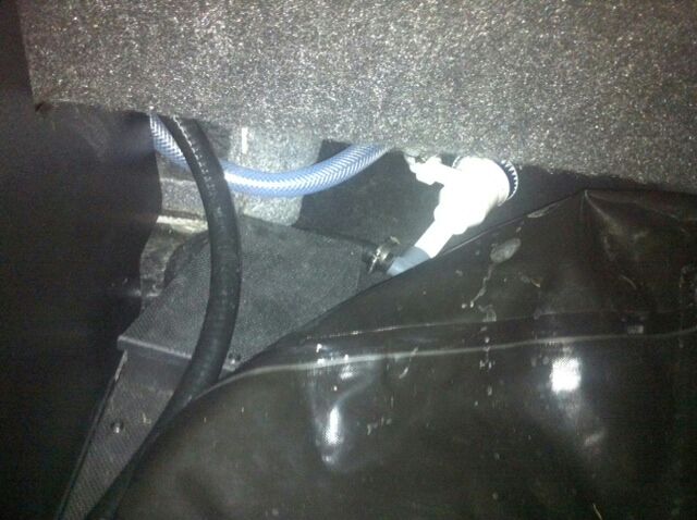

I T`d into the drain from the sack to the hard tank with the pump.

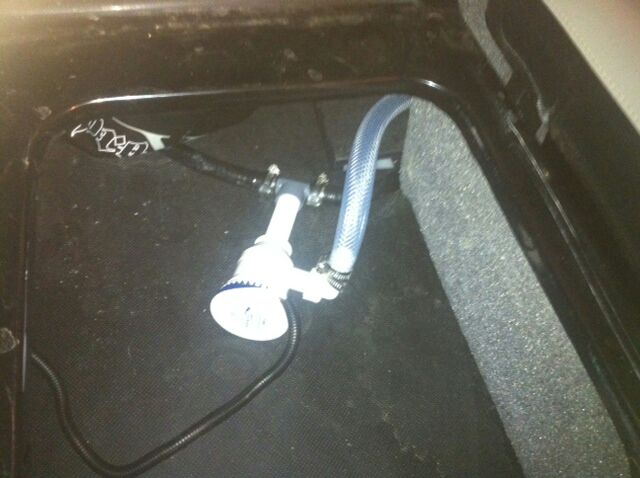

I ran the pump output into the drain line from the pump in the hard tank.

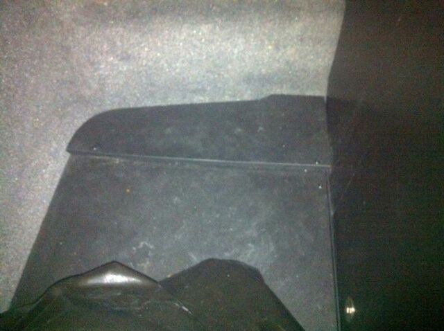

Remove the cover in the back of the v-drive compartment. You will see the other pump in their. Splice the wires from your tsunami into the wires in here. Brown to brown, black to black.
Since you wired into the other pump, they both run from the switch. Aerator pumps wont burn up from running dry so it doesnt matter which one drains first. The tank pump will empty the tank and the bag pump will empty the bag while it is draining into the tank. The bags empty completely and quickly. No more waiting and holding the bags up to try to speed them up!
