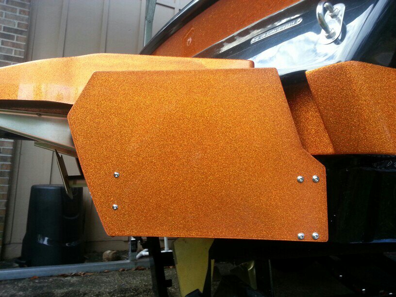

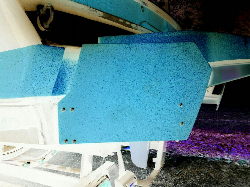

Attached are the measurements for my surfgate. All the measurements are in inches. I don't know how to get the angles. I don't have the tool required for angel measurement. Any suggestions?

Thanks Dezul! If you or anyone else can take a pic with camera positioned directly in the center of surfgate and level/square (size or cropping does not matter) I can turn the pic into a template.

Will do tomorrow.

PostPosted: Sun Oct 13, 2013 7:26 am
Negative

PostPosted: Sun Oct 13, 2013 7:27 am
Starboard

Thanks! That will work just fine. Later today Ill; transfer the measurements, cleanup the image , and scale it to actual size to make a good template. Since most folks dont have a large format printer, Ill split is up across 4 pages and add alignment dots.
