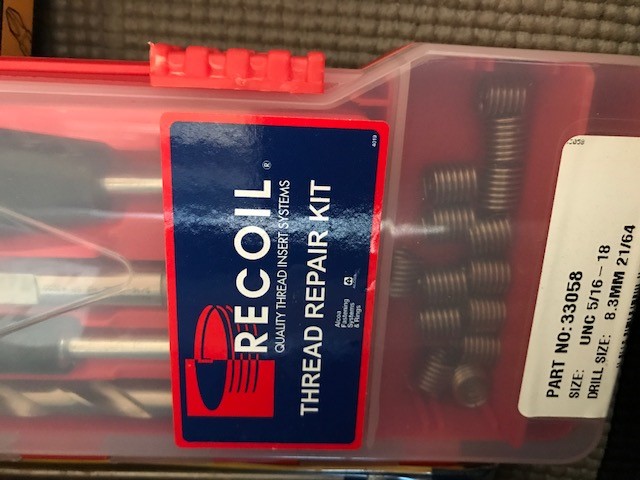

Location: Conroe, TX
I had the exact same problem. Just get a thread repair kit and follow the instructions. I used a recoil thread repair kit and it worked like a champ.
That's the plan! Thanks

admin wrote:
Good tip.
I agree! I could not come up with an easy fix but this looks like it!
