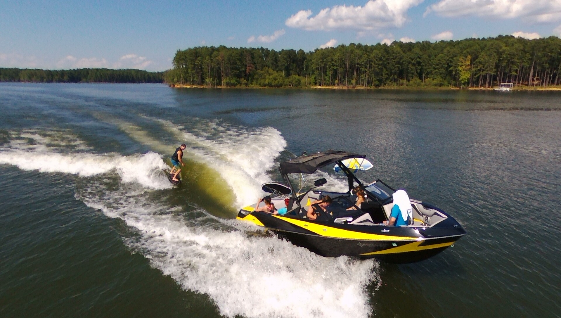

Here is my set up:
650lb Bow bag with 150lb steel shot up front.
750lb rear sacks
Wedge down
11.4 mph
Anything slower then 11.4 the wave is not real clean. When I speed up I find I lose surfers to easily and spend too much time circling around. With the wedge down I like at least one larger body up front. At that speed I also find I can ride fairly far back on the wave and still recover.
https://vimeo.com/225026863
I rode behind a 2014 G25 Nautique last weekend. The Axis T23 wave is better!
