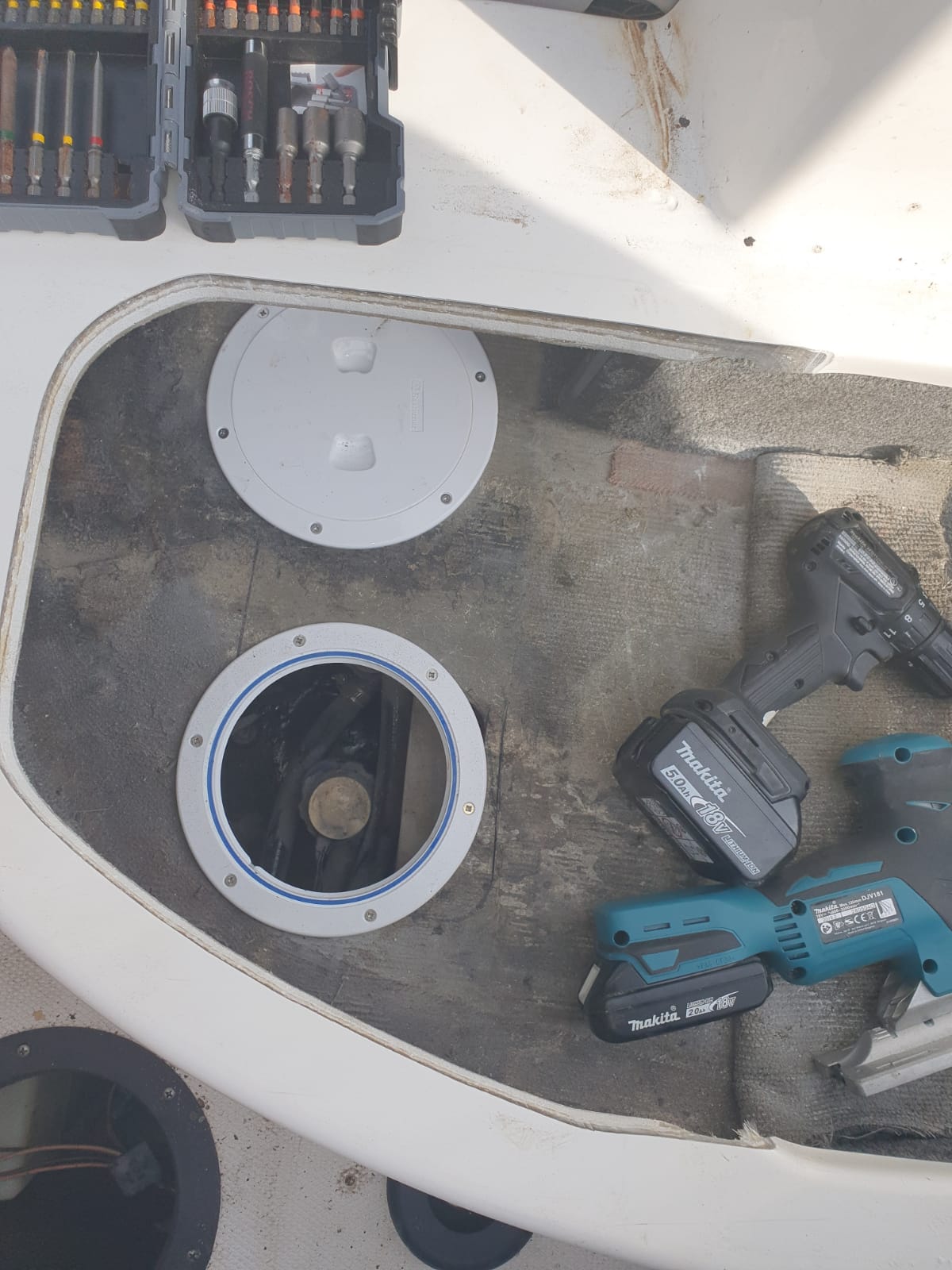

I wanted to upgrade the pumps to 1100gph - there was no way I could see being able to do this through the black circular hatch by the drivers seat so I cut away a section of the walkthrough and added 2 more hatches into the floor. I will drill another circular hole which will be the fill / drain line for the bow arrow sac and allow water to drain into the center bilge..
