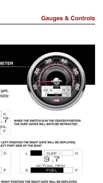

The fuse box I checked above the trans did not have a fuse labeled for the surf gate. There were 3 relays and about 5-6 fuses if I remember correctly. Is there an inline fuse somewhere? Also my surf gate gauge looks different than before. I do not have the black surf box as shown in this photo. It use to when it was working
2014 A20

If you don't have that black display box where does it tell you on the dash that your gate is deployed?
