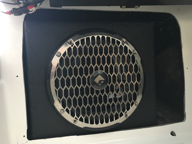

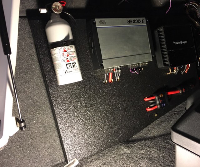

I'm not very mechanical but with the help on this forum I built a box out of 3/4 birch and then used rhino lining, did an amp board as well the same way. Couldn't be happier and in the end wasn't too difficult. Today I'm adding ABS to fill in the sub area to get it cleaned up.
